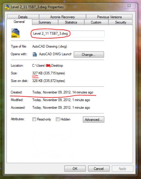

Dadgad
What is ACRONIS RECOVERY?
Share this post
Link to post
DashaB
According to the internet, a backup service of some sort?
Share this post
Link to post
Dadgad
Saved as a template?

ReMark
Just repeated it.

Dadgad
I don't doubt for a second that you did it, I am surprised to see that you use AutoCAD DWG Launcher though to open your files. :beer:

ReMark
BTW...it was saved in AutoCAD 2010 file format and not in any legacy file format.

ReMark
I don't mind sharing. For a moment there I thought you might have wondered if I was attempting to pull some sort of trick on you. I wasn't.
I opened the file, which did take about 30 seconds on my home computer (not the same setup as work but close), then I did a DXFOUT. Opened a new drawing and did a DXFIN. Saved the drawing which actually grew the file size. Closed the drawing. Reopened the drawing and saved it again. File size reduced. Done. Repeated this a second time to confirm the procedure was indeed valid and repeatable. Satisfied?

DashaB
Haha trust me, i did not think you were pulling a trick on me, I've just been extremely frustrated with this whole process because somehow, it became my responsibility to fix this for our entire company, and the longer it was not fixed, they would just sit there and complain about it lol..
So. I did exactly what you said on another drawing, same project and same problem, just different floor.. Original was 18.8MB.
After your trick, 12.5 MB, which is better, but not really the same result you had. I'll try re-running it again to see if that helps any.Capture3.JPG

DashaB
Ok, the second go-around make it 379 kb. Awesome!
