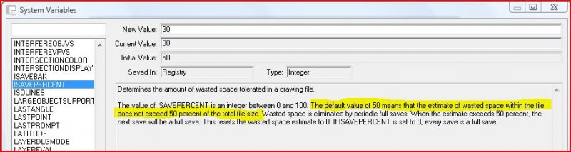

Dadgad
What is your ISAVEPERCENT set to?
If it is not set to 0, then set it to zero and do a SAVE.
Are you using ADAPTIVE DEGRADATION?
If not it would likely help, not the file size, but speed of operations.
Set your FPS threshold to 60, instead of the default value of 5.

DashaB
ISAVEPERCENT was set to 50. Changed it to 0 and it still took about 14 seconds to do a save.
I am using adaptive degregation.
Also as a side note, I am not sure if I mentioned that this problem has only begun happening since our office switched to 2013 and it is office-wide.

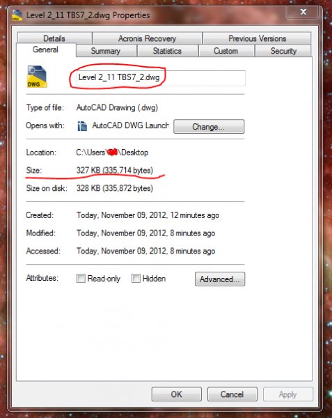

ReMark
The very first thing I noticed is you have a 18.1MB CAD drawing and there isn't a single block. Just lines, circles, and lwpolylines. Was this intentional?
7155 individual objects.
Share this post
Link to post
Dadgad
What have you set your ADAPTIVE DEGRADATION threshold to, 60?
Share this post
Link to post
ReMark
Mine is set at 5.
I got the file size down to 327KB. Loads like a charm.
Share this post
Link to post
