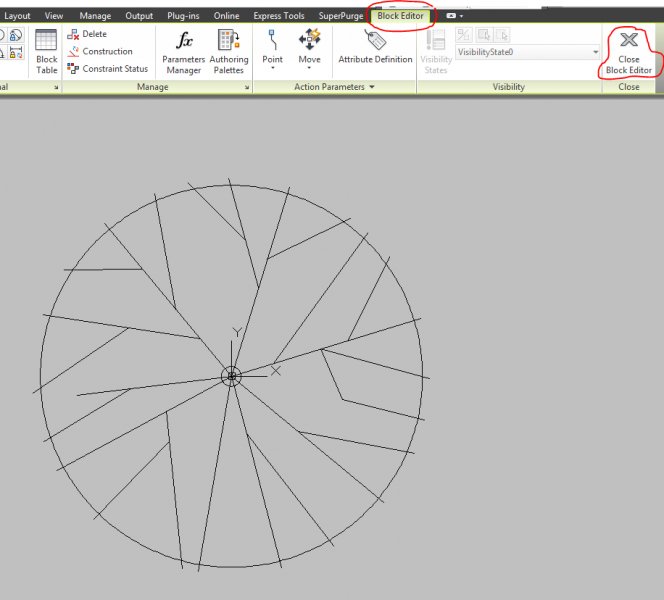

ReMark Posted December 10, 2012 Share Posted December 10, 2012 On the same page P-F has one other surprise for you. They now say all trees must have a diameter of 10 feet not 15. They want you to Explode and remake your block. Let's not but say we did. Instead I suggest you use the Block Edit command or BEDIT for short. Invoke the command and highlight the Tree-Oleson block. When the block editor opens you'll see your tree. I want you to use the Scale command and scale the entire tree using as the basepoint the center point of the tree. Use 0.6667 as the scale factor (15*0.6667=10.0005 or "close enough"). Close the Block Editor by clicking on the "X" in the upper right hand corner of the window. You want to keep your changes. When you are returned to your drawing all the trees will be smaller. Measure the diameter of one of them to prove they are indeed "10" not "15". The Block Editor dialog window: Quote Link to comment Share on other sites More sharing options...
ReMark Posted December 10, 2012 Share Posted December 10, 2012 Our tree block inside the Block Editor itself. Quote Link to comment Share on other sites More sharing options...

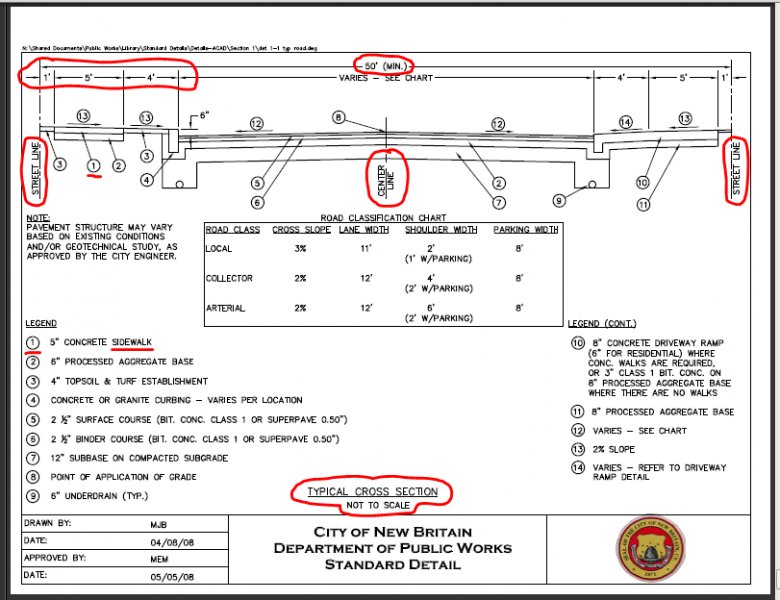

AutoCad Student Posted December 11, 2012 Author Share Posted December 11, 2012 (edited) For sure I will keep you posted on my progress. Your help has been a miracle to say the least. I lost some momentum due to some unexpected events in the evenings a couple of nights and the sidewalk section held me up quite a bit. So back to the sidewalk section again, so the street line is the outer most boundary???? I know you gave me a great explanation and photo, but in my pea brain it seems the street line would be the inner most line, then the curb then the sidewalk, then the buffer. If you walk out of your house and go toward the sidewalk, you get to the sidewalk first, then the curb, then the street. I'm pretty confused on this section. Also, will I need to delete that perimeter line and box boundary you had me draw at the very beginning? I don't seem to recall that listed in the directions but maybe i over looked it in my panicked state! haha Edited December 11, 2012 by AutoCad Student Quote Link to comment Share on other sites More sharing options...

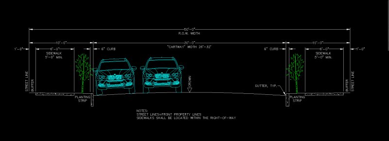

ReMark Posted December 11, 2012 Share Posted December 11, 2012 (edited) Re: streetlines and the location of buffers, sidewalks, planting strips (not parking strips) and curbs. I will state this as plainly as I can. Here goes....The sketch provided by a faculty member of Penn-Foster posted to another Oleson Village thread is wrong. Refer to post #68 below. I have researched this a couple of times already but to provide everyone with some proof to back me up I have attached a copy of a typical street cross-section detail as called for by the City of New Britain (state of Connecticut) Engineering Department that I worked in for a period of eight years. The so called "buffer" is a one foot offset from the streetline to the back of walk. This is so contractors installing sidewalks do not disturb property pins or monuments. Then you have the sidewalk itself, a grassy strip, and finally the granite or concrete curb. On a street with a streetline width of 50 feet, subtracting out 10 feet on either side for the buffer, sidewalk, etc. the end result is a paved roadway of 30 feet. This method of laying out a road is widely used across the country. You will find variations in streeline widths (up to 75 feet for a "boulevard") as well as for sidewalk and planting strip widths. Another reference. Santa Monica, California - Right of way Information. http://www.smgov.net/departments/publicworks/streetrow.aspx Bottom line. Draw the plan the correct way or draw it the Penn-Foster way. If you draw it the correct way and points are taken off you can cite the above example as one of many that can be found online. For further information pick up the phone and call your local Public Works or Engineering Department and ask them what falls between streetlines. Edited December 11, 2012 by ReMark Quote Link to comment Share on other sites More sharing options...
ReMark Posted December 11, 2012 Share Posted December 11, 2012 A little more of a graphical approach re: street cross-section. Quote Link to comment Share on other sites More sharing options...

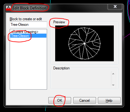

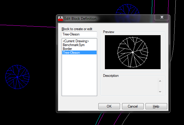

AutoCad Student Posted December 17, 2012 Author Share Posted December 17, 2012 (edited) ok, things are progressing nicely. I tried to insert the north arrow and its about 400 times too big. How do i resize it? Also, when I try to edit the tree block, its not visable when I type bedit. The editor opens up but my tree isn't listed. Edited December 17, 2012 by AutoCad Student Quote Link to comment Share on other sites More sharing options...
ReMark Posted December 17, 2012 Share Posted December 17, 2012 You can resize the north arrow using the Scale command. Quote Link to comment Share on other sites More sharing options...
ReMark Posted December 17, 2012 Share Posted December 17, 2012 Click on one of your tree blocks then go to your command line and type BEDIT followed by pressing the Enter key. This is what you should see. You did download the Tree-Oleson block I posted correct? You did not explode the block did you? Did you change your model space background color to white by any chance? Quote Link to comment Share on other sites More sharing options...
