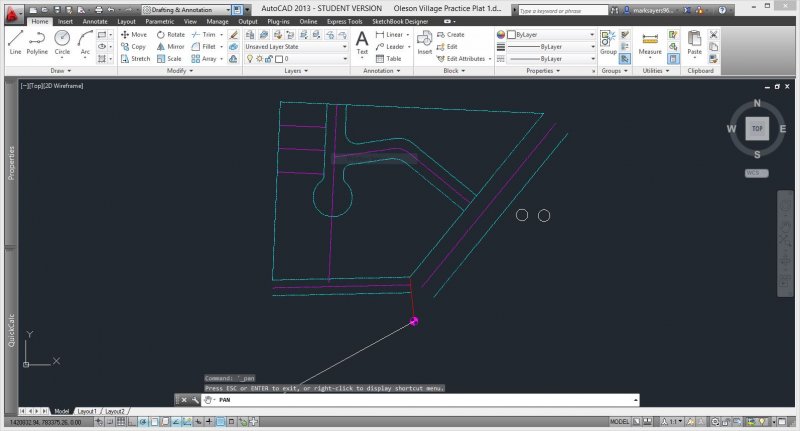

I see you are running Win8. There should be a feature called the Snipping Tool included with the OS. Use it to create an image (PNG). The background of the image will be exactly the same as the one in AutoCAD.

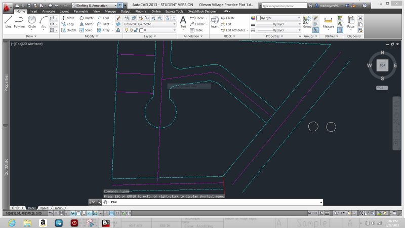

The above image was created using the Snipping Tool that was included with Windows 7. My background in AutoCAD is normally black to begin with. The screen capture shows exactly what I am seeing. There is no need to "convert" or change the background color.

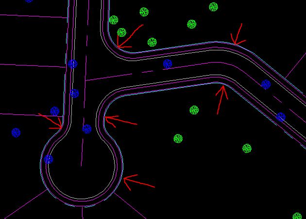

Are the radii the red arrows point to the ones you are inquiring about? If "yes" what is your particular problem?
Yes I like to use the black background also, easy on the eyes.. I just got home and going to find snipping tool to get this uploading problem solved.
The radii on south end of SW Village Rd. and where the cul-de-sac join is my biggest problem. I could not get Fillet to 30 foot radius.
I got north end to the 30, I had gone in to properties and changed it from the 20 to a 30 foot radius. Did I read in one of your post that is a bad practice? Changing the property of an entity that way.

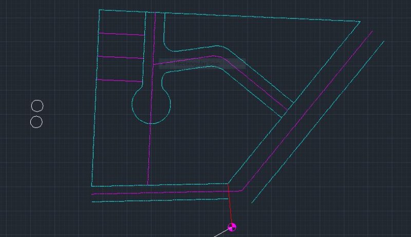

Got all my radii corrected and touched up and trimmed a few things. Trying to complete this by the book and then check it with your work and posts. Capture.jpg

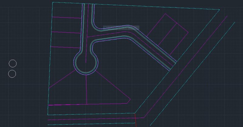

Thank you, here is what I have as of today. Had my boys Friday and Saturday so I only worked on it Sunday. Your posts have helped me big time!! Being new it is hard to see the light lol as to how to and where to start an entity. take lot 4 for example, the south border. Once I saw you used circles and Q-snap it all came together. once you see it done everything clicks and comes together.Capture.jpg
