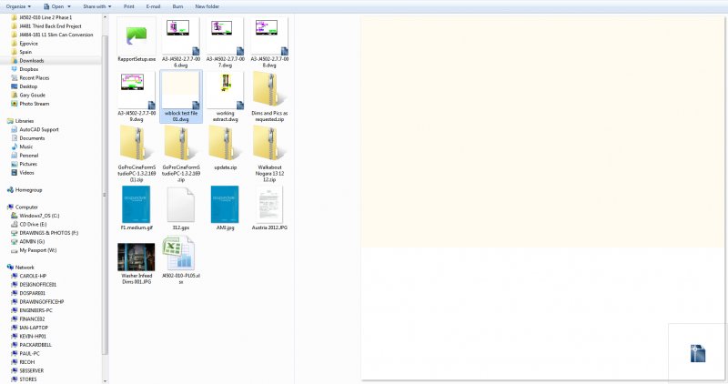

garygoude Posted December 18, 2012 Share Posted December 18, 2012 Recently starting having this problem. 1-2 months ago it was not a problem. I am not aware of any system variables being changed. When using the WBLOCK command, no thumbnail preview is being saved with the block for previewing in Windows Explorer. I have check the RASTERPREVIEW system variable is set to 1, but this makes no difference. When saving files normally I do not have a problem. The block previews are very useful for my day to day work, so if anyone can help I will be very grateful. Using AutoCAD 2011. Thanks, Gary Quote Link to comment Share on other sites More sharing options...

garygoude Posted December 18, 2012 Author Share Posted December 18, 2012 download a wblock file i have just created here: http://mecatec.co.uk/Downloads/wblock test file 01.dwg download a png screenshot of what I preview in windows explorer here (you will see some files are visable as thumbnails and the wblock file is a creamy colour...): http://mecatec.co.uk/Downloads/screenshot of explorer.png Quote Link to comment Share on other sites More sharing options...

KFW Posted December 19, 2012 Share Posted December 19, 2012 Öhm, there is a thumbnail in your picture. But it shows only your "Blank-Model-Backround" half page and the rest is white, isn't it? Ithink my picture explains it (only tested with Acad 2012 and 2013). Before -wblock did you use zoom extend and save that drawing. If I'm wrong ... Sorry Quote Link to comment Share on other sites More sharing options...
garygoude Posted December 19, 2012 Author Share Posted December 19, 2012 Hi KFW, appreciate your input, I have just spent a few minutes trying this and other zoom positions and still nothing the thumbnail I get is still cream arrghh! Thank you though! Quote Link to comment Share on other sites More sharing options...
