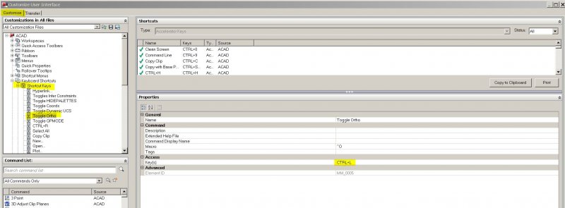

Dadgad Posted January 9, 2013 Share Posted January 9, 2013 (edited) Welcome to CADTutor. Per ReMark's post, the following image shows where you would change your shortcut key to toggle ORTHO on and off. Lynn Allen has a post, which I think she calls here most popular customization, regarding changing the F1 key to something other than HELP, here is that link It would seem to me that using Q & W would be more efficient than using the F keys, because they are closer to where my left hand is usually stationed. Edited January 9, 2013 by Dadgad Quote Link to comment Share on other sites More sharing options...

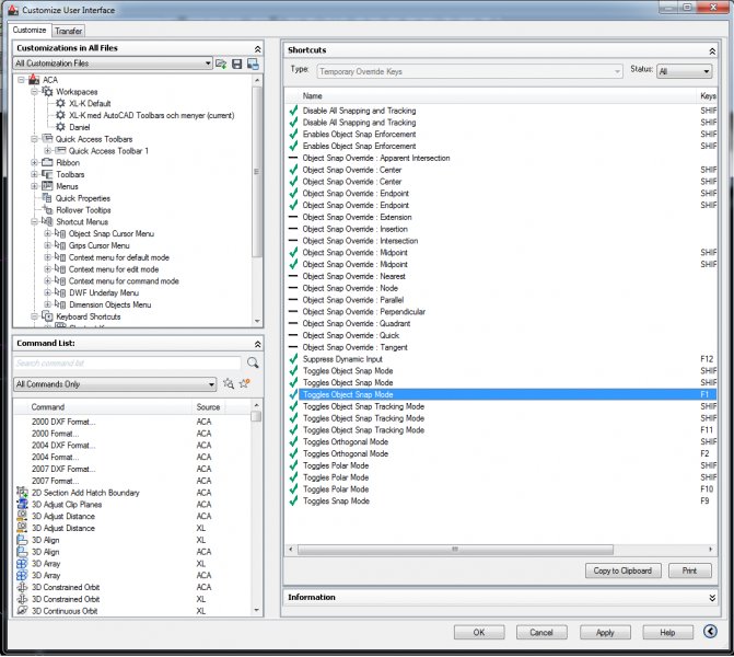

danzi Posted January 9, 2013 Author Share Posted January 9, 2013 F1 = Help F2 is your text window. Are you just going to ditch those two? Re: Ctrl+W and Ctrl+E. Wouldn't these entries be made in the CUI under Shortcut Keys? Yes I know but I want to change place for them, i.e. default F1 to F3 and default F3 to F1, and default F2 to F8 and default F8 to F1. Thanks for the help Dadgad. I found where to change the shortcutkeys for default F3 and default F8. However I ran into some new problems. When I change them, as you can see in the picture, the F1 key still refers to help, not osnap, and the F2 key still refers to text window. I figure I must change the shortcutkey for help and text window, but I can´t found where it is. Anyone who knows were it is? Quote Link to comment Share on other sites More sharing options...
Dadgad Posted January 9, 2013 Share Posted January 9, 2013 (edited) Yes I know but I want to change place for them, i.e. default F1 to F3 and default F3 to F1, and default F2 to F8 and default F8 to F1. Thanks for the help Dadgad. I found where to change the shortcutkeys for default F3 and default F8. However I ran into some new problems. When I change them, as you can see in the picture, the F1 key still refers to help, not osnap, and the F2 key still refers to text window. I figure I must change the shortcutkey for help and text window, but I can´t found where it is. Anyone who knows were it is? [ATTACH=CONFIG]39512[/ATTACH] Did you watch the Lynn Allen link which I posted? I believe it may help you, which is of course why I posted it. And it does deal specifically with customizing the F1 key. I just watched it again, strongly suggest you do too. Edited January 9, 2013 by Dadgad Quote Link to comment Share on other sites More sharing options...

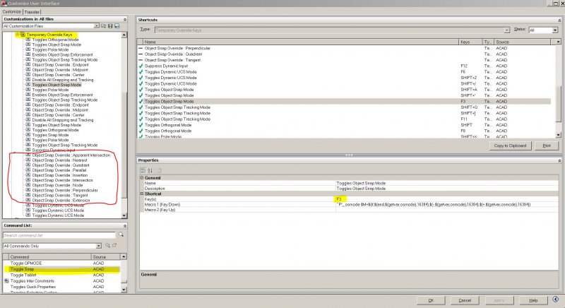

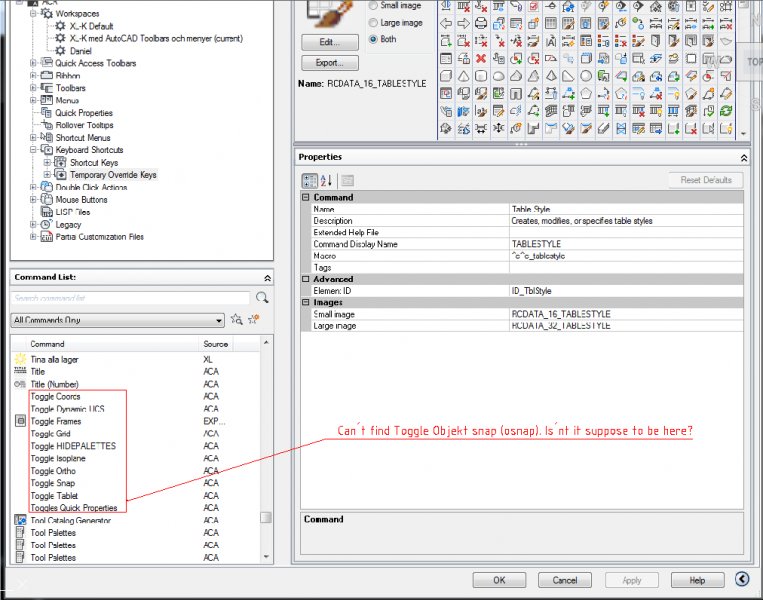

danzi Posted January 9, 2013 Author Share Posted January 9, 2013 Did you watch the Lynn Allen link which I posted?I believe it may help you, which is of course why I posted it. And it does deal specifically with customizing the F1 key. I just watched it again, strongly suggest you do too. Okej I see what I did wrong there. I was in the temporary override keys and changed the shortcut. I solved the Toggle ortho as Lynn Allen described it. Howerever when I want to change the Toggle object snap it is´nt located in the same place as Toggle ortho, see picture. Is´nt it suppose to be there? And if not where do I find it? Quote Link to comment Share on other sites More sharing options...
Dadgad Posted January 10, 2013 Share Posted January 10, 2013 Okej I see what I did wrong there. I was in the temporary override keys and changed the shortcut. I solved the Toggle ortho as Lynn Allen described it. Howerever when I want to change the Toggle object snap it is´nt located in the same place as Toggle ortho, see picture. Is´nt it suppose to be there? And if not where do I find it?[ATTACH=CONFIG]39515[/ATTACH] Glad you got that sorted. I think the image will help you find what you are after. Quote Link to comment Share on other sites More sharing options...
