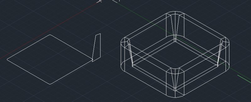

TKall Posted January 17, 2013 Share Posted January 17, 2013 Hello everyone. I have been following the questions and answers here for a few months and learned a great deal. Thank you all. I never thought I would need to learn AutoCAD and still wish my draftsperson hadn't run off with that marauding outlaw motorcycle gang...but that's another story and I sincerely hope she, the baby and (I think his name is Blaze) are well. I have been trying to draw a precast concrete tank and have run into a problem. The tank walls are not constant thickness. At the bottom they are 3.5" thick and taper to 3" thick at the top. Also, the top dimensions of the tank are longer and wider than the bottom dimensions of the tank. My solution has been to draw the outside bottom as a rectangle and offset the rectangle by 3.5". Then repeat this for the top dimensions, set the top two rectangles at the correct elevation and loft them. Then, I press-pull the center out of the tank. This results in a quasi-correct representation of the outside tank but the wall thickness does not taper correctly and the walls are hollow. I can post a link to the manufacturers drawing of the tank. Thank you for your help I really appreciate it. Quote Link to comment Share on other sites More sharing options...
MSasu Posted January 17, 2013 Share Posted January 17, 2013 So, the tank should look in transversal section like the sketch below, if I had read you correctly: In this case you may draw the plan shapes marked 1 to 4, in their respective location (that it, on Z) and then apply the LOFT command on the pairs 1 and 2, respectively 3 and 4. You will get now two solids; use the SUBTRACT command to remove the small item from the outside one and this should give you the hollow tank you were looking for. Quote Link to comment Share on other sites More sharing options...

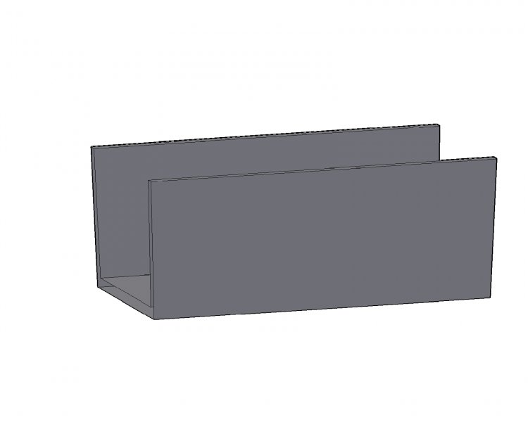

BIGAL Posted January 17, 2013 Share Posted January 17, 2013 Like msasu draw shape use rotate3d to stand up the draw a pline for the base use vpoint 1,1,1 to see whats happening extrude Path Ps for a laugh this has no bottom ! added bottom re extruded the original pline then union Quote Link to comment Share on other sites More sharing options...

TKall Posted January 17, 2013 Author Share Posted January 17, 2013 I thought I had it by drawing the sections with plines and lofting them together. My walls are still hollow and now I am not sure how to finish the ends of the tank. I would uploaded the dwg file but was not sure how to do that. The manufacturers pdf is at this link:http://www.billingsprecast.com/Combo%20Tanks/SDCE15S%20-%20Eliminite%20120C%201000-500%20Gal%20Combo%20-%20SP%20-%20Copy.pdf I appreciate the help and advice. Tom Quote Link to comment Share on other sites More sharing options...

Dadgad Posted January 18, 2013 Share Posted January 18, 2013 I thought I had it by drawing the sections with plines and lofting them together. My walls are still hollow and now I am not sure how to finish the ends of the tank. I would uploaded the dwg file but was not sure how to do that. The manufacturers pdf is at this link:http://www.billingsprecast.com/Combo%20Tanks/SDCE15S%20-%20Eliminite%20120C%201000-500%20Gal%20Combo%20-%20SP%20-%20Copy.pdf I appreciate the help and advice.Tom[ATTACH=CONFIG]39664[/ATTACH] Were the PLINES which you lofted CLOSED or OPEN? Mid command one of the commandline options is MODE, you may want to specify SO for solid. If your PLINES were closed, it should have defaulted to SOLID, so I would guess that your PLINES were OPEN. In a linear situation like this you could have used EXTRUDE, instead of LOFT, (or SWEEP or PRESSPULL) although either could work. I suggest you try BIGAL's suggestion in post # 4. Quote Link to comment Share on other sites More sharing options...

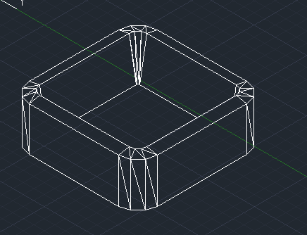

TKall Posted January 18, 2013 Author Share Posted January 18, 2013 ReMark: I want a solid tank wall. The surfaces would not matter that much, but if I am going to take the time, I want to get it right. And considering that incredible guitar of yours, I think I should be able to figure out a concrete tank....even if it takes me a month! Dadgad: I drew plines, snapping to the appropriate location. When I was done I used the join command to create one object. I then selected the outside sections and used the Loft command. I wondered why I got surfaces instead of a two solids form which I could subtract one. I am confused by the fact that the tank walls are not at right angles but rather, "splay" out along the length and width. Quote Link to comment Share on other sites More sharing options...
the downing effect Posted January 18, 2013 Share Posted January 18, 2013 The pdf is missing quite a few dimensions, but there are a couple of ways to get a solid instead of surfaces. One is to use the pedit>m>yes>join>0 to create a closed polyline out of your sketch then extrude one sketch or use loft between two, you could also create a region and extrude it, or use press pull to extend the sketch to the proper length. Basically you use closed profiles to create solids or open profiles to create surfaces. If applicable you can thicken surfaces to create solids but I don't think that will help in this case. Quote Link to comment Share on other sites More sharing options...
TKall Posted January 18, 2013 Author Share Posted January 18, 2013 I started over and drew the sections with plines and lofted them. This gave me the everything minus the ends. For the ends I drew two new sections for each end and lofted them. then I used the union command to make one solid and deleted the plines. It looks good. Thanks everyone. Quote Link to comment Share on other sites More sharing options...

BIGAL Posted January 19, 2013 Share Posted January 19, 2013 Once you get used to rotate3d it solves heaps of what appears simple like this tank. Another example http://www.cadtutor.net/forum/showthread.php?76675-Help-to-rotate-Hand-Rail-in-3D Quote Link to comment Share on other sites More sharing options...

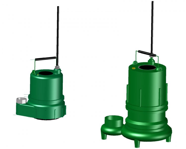

TKall Posted January 19, 2013 Author Share Posted January 19, 2013 I have been playing with the method that BIGAL described. You can draw a lot of interesting shapes with that but it took me a little while to get my brain around it. I drew my submersible pumps, and I must say for my first 3d drawings, they look pretty good. I am kind of amazed to find a forum so packed with real experts. Do any of you write computer code, C#, VB.net, Java???? Quote Link to comment Share on other sites More sharing options...
ReMark Posted January 19, 2013 Share Posted January 19, 2013 Post an image of your submersible pump. We'd all like to share in your new found skills. Quote Link to comment Share on other sites More sharing options...
TKall Posted January 19, 2013 Author Share Posted January 19, 2013 Two Hydromatic submersible effluent pumps, OSP 50 and SKHS 100. Quote Link to comment Share on other sites More sharing options...
