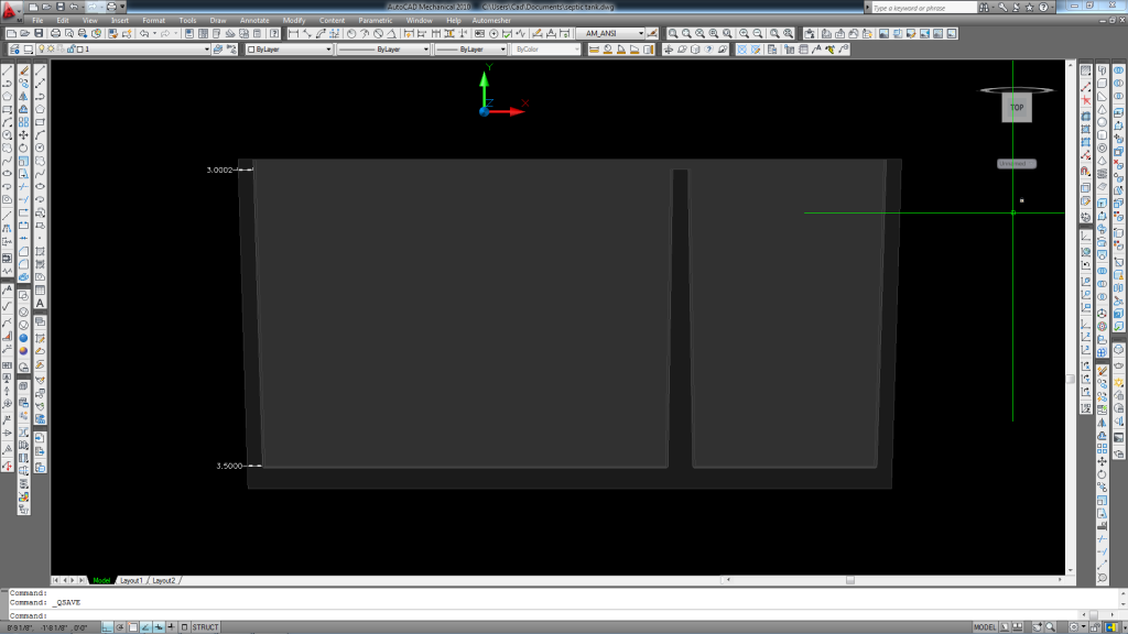

Jimmy111 Posted January 20, 2013 Share Posted January 20, 2013 Jimmy11 from a structural point of view there is actually a flaw in this concrete tank shape where the wall meets the floor there would be a chamfer or radius to reduce the shear stress possibly also in the wall corners, so trying to use two cubes plus other shapes to produce the reult would take a long time using a profile and a path took a couple of minutes. Tkall nice images might pinch we are doing a $1,000,000 pump station project at moment. It only takes about 5 minutes to draw this tank.. Wait a few. Quote Link to comment Share on other sites More sharing options...
Jimmy111 Posted January 20, 2013 Share Posted January 20, 2013 Ok that took about 10 minutes But quite fast. Took longer to calculate the draft angle than draw the thing. Quote Link to comment Share on other sites More sharing options...
TKall Posted January 20, 2013 Author Share Posted January 20, 2013 That looks good Jimmy. And the walls are solid. My tank, which I made with the Loft command, has hollow walls. It looks ok, but it is not perfect. If you get the time I would like to know what you did. We use these tanks to build our treatment systems. I also would like to know how to create a hatch pattern from a photo. Quote Link to comment Share on other sites More sharing options...
Jimmy111 Posted January 21, 2013 Share Posted January 21, 2013 Very simple. Like I said before. I drew a rectangle of the outside dimentions then extruded it with a 1.75 Degree taper. Then I drew a rectangle of the inside cavity and extruded it with a taper. The subtracted the inner from the outer. Then made the partition and joined the 2 solids. Then filleted the inside with a 1/2" radai. Took less than 10 minutes. I used to do a lot of work like this. Quote Link to comment Share on other sites More sharing options...
TKall Posted January 21, 2013 Author Share Posted January 21, 2013 Jimmy: I tried it. Pretty slick. I just extruded both shapes, put the smaller one inside the larger and, like you said, subtracted the smaller from the larger. Thanks man. Tom Quote Link to comment Share on other sites More sharing options...
TKall Posted January 21, 2013 Author Share Posted January 21, 2013 I see..this works with any type of solid. Quote Link to comment Share on other sites More sharing options...

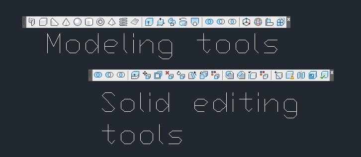

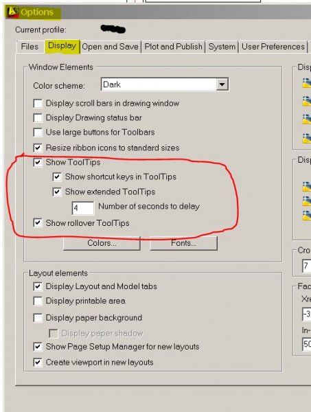

Dadgad Posted January 21, 2013 Share Posted January 21, 2013 You should really spend a few minutes looking at the MODELING panel on the ribbon or TOOLBAR, there are really only a few basic concepts which will cover 90% of things you want to model. Once they start to make sense you should explore the SOLID EDITING toolbar or panel. UNION, SUBTRACT, INTERSECT, and INTERFERE are very important when modeling 3D SOLIDS. If you have your HOVER TIPS turned on, just hovering over those icons for a couple seconds will expand an instructional window, some have videos in them, to quickly describe what they do, and how they are used. Quote Link to comment Share on other sites More sharing options...
TKall Posted January 21, 2013 Author Share Posted January 21, 2013 :roll:Ok...I'll spend a few minutes. Dadgad...I'm a newbie man. The learning curve for this is so steep, I need a harness and a pair of linemans boots, you know the ones with the spikes. I have been working every tutorial and when someone on this forum has a technique I explore it. So please, keep them coming. I can't tell you how much I appreciate this site. Tom Quote Link to comment Share on other sites More sharing options...
Dadgad Posted January 21, 2013 Share Posted January 21, 2013 Excellent, I feared that you had steered clear of the tutorials, on the buzz you got from modeling those submersible pumps. In light of your having done such a nice job on those, I was surprised by your reaction to the SUBTRACT functionality, which is really a cornerstone of the whole modeling mind and toolset. UNION is addition, SUBTRACT is subtraction, INTERSECT is all common volumes, and pretty much the same as INTERFERE, but INTERFERE gives you some interesting options when you discover CLASHES (solids in the same space, where you don't want them to be), such as deleting the interference object, or saving it, if you have need of it. They make some pretty nice guitars up in Bozeman these days. Quote Link to comment Share on other sites More sharing options...
