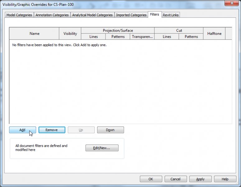

pcslam Posted January 22, 2013 Share Posted January 22, 2013 Hi I am new to the forum, I have been trying to figure out whether or not Revit Architecture 2011 has layers like in AutoCAD. It's fairly easy to make your work visually pleasing in terms of the line weights in different views. I would really love to apply the same effects to my drawings in Revit. I was wondering if someone could enlighten me on how to go about making my Revit drawings more clear with more detailed lines or layers, etc. Thank you in advance! Quote Link to comment Share on other sites More sharing options...
Lee Roy Posted January 22, 2013 Share Posted January 22, 2013 The first rule to learning Revit is IT IS NOT LIKE AUTOCAD There are no layers. Unlike AutoCAD, what you see on the screen is exactly what you will see on the paper, no stupid color translations. Check your Visibility/Graphics Overrides, Object Styles and Filters for setting and playing with line and object styles. Quote Link to comment Share on other sites More sharing options...

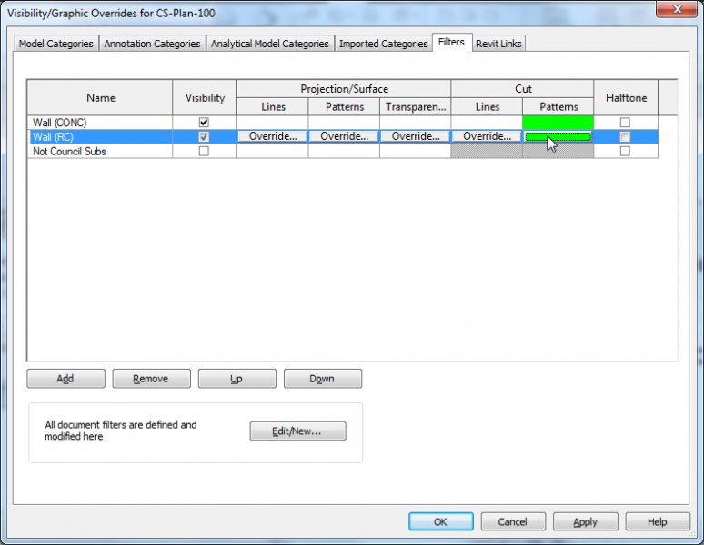

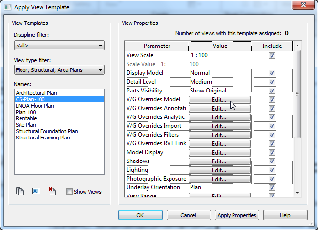

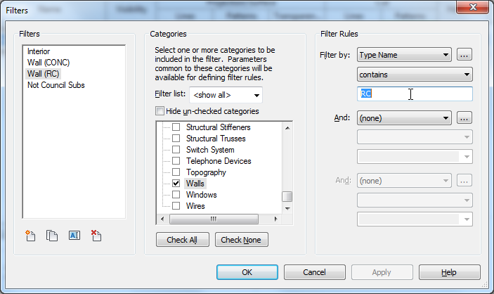

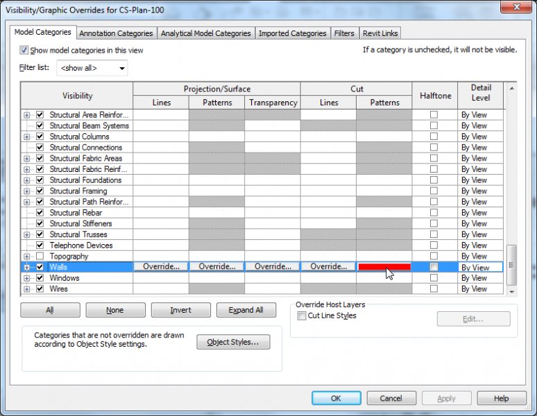

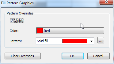

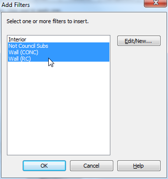

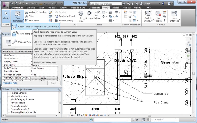

irneb Posted January 23, 2013 Share Posted January 23, 2013 As an example. I'm making a view into something for council submissions. They've got particular colouring requirements for things like brickwork (red solid fill) as opposed RC (green solid fill). Our normal wall type displays with a brickwork hatch like this (note I'm directly going through a View Template since I want to apply this to multiple views without going through all the steps again and again): This opens the Apply View Template, I create / select a template I've made myself. Then click on the VG Overrides: This opens a VG dialog for this template. Here I adjust the default cut pattern for all walls (i.e. when the view sections through a wall) - to a solid fill red: But how do I distinguish a Concrete / RC wall? In this case I'm going to use Filters (note these are a lot nicer than acad's layer filters as they apply overrides automatically). Open the VG dialog's Filters tab, click add and select the filter(s) I want (note you create your own - see later in this post): Then you add overrides for each filter, same as you do for object styles: If you don't already have filters set up, then you can add them from the same dialog(s): Finally after clicking the OK in the View Template Apply dialog, my view adjusts to the new settings: You can select multiple views in the project browser, right-click on one of them and select Apply View Template. This would then set that view template to all of them at once. IMO this is even better than using ACad's Layer States. Quote Link to comment Share on other sites More sharing options...
