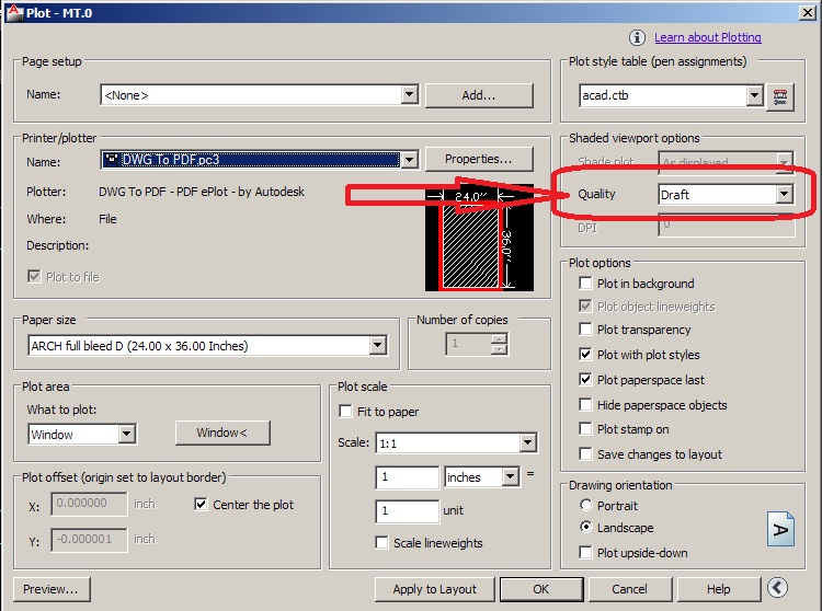

Here are three images. The first is what my image is supposed to look like, the second is what it looks like when I try to pdf it, and the third is my plot dialog box, which was requested by another member. As you can see, the image gets horribly pixely when I try to pdf the drawing but my co worker, printing the same drawing using the same CutePDF Writer "printer", can print the image just fine because she can change her work space to some sort of "2D" work space. It doesn't appear to do anything until you print, because when we try to print in a normal work space the pixels happen.

Workspaces only present you with a defined set of preferred/personalized tools and has NOTHING TO DO WITH PLOTTER OUTPUT.

SLW210
You need to set the Quality to Draft.

That does work, it gives me the 2D wire frame of the image basically. What would I need to upgrade or update on my computer to print a better quality image?

I did try using the built in PDF converter (DWG to PDF.pc3) so I thought I wouldn't need a ghost script. I assumed AutoCAD MEP 2013 has that set up. What happens, though, when I print draft is the 2D wire frame look instead of showing the filled in extruded shapes, and going beyond draft quality makes it pixelated. My co worker has the same computer as I do though and has no problem with a pixelated image when she prints 3D drawings to PDF.
