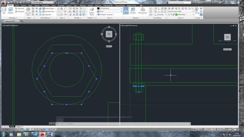

I have experience making 3D models in Vectorworks but have never used 3D in AutoCAD. I am using 2014 version. I understand the principle of UCS and the idea behind it but am really struggling to use it.
Currently I am trying to use two viewports, one in top view and one in front view.
I am trying to use the two to ensure I am placing objects in the correct place in relation to everything else. However...how comes when I move something up or down in front view it moves completely out of position in top view? surely if i'm moving the object up or down it should not effect the position of anything in top view? :oops:

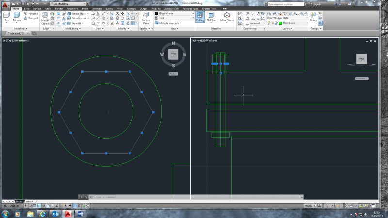

Hi there, thank you for your response. I tried that...I either did it wrong or it didn't work. Do these images help?
before
after

em3108
the more fine green line to the left of the front view is the ucs line...

tonyj
It looks to me that your right hand viewport is not in plan view, but is slightly off. Then for that reason when you move the part from top to bottom (in your viewport) you are actually moving it down slightly (slightly been the amount your viewport is off plan). Try making a ucs by 'face' and select the top face of the nut.
