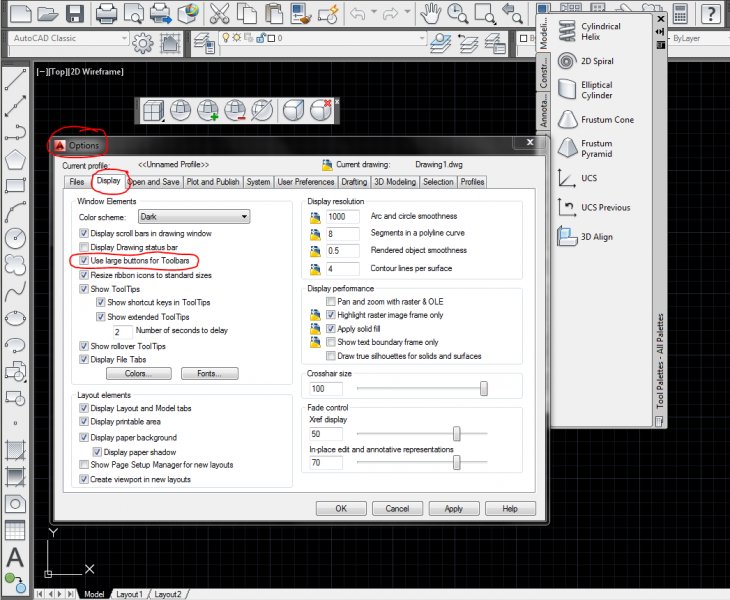

Nevermind. I found a solution to your problem. Go to Options > Display.
Use LARGE buttons for Toolbars.

i tried it... but with large buttons it hasnt been showed all my toolbars....
but thank you for your suggestion :-)
