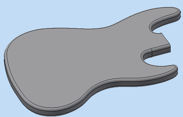

jongor
using fillet on a complex solid
jongor
I redrew the outline, much simpler now, see attached.
The white lines aren't joined because those don't need to be filleted.
Extruding just the red creates an extruded surface, which can't be filleted
Joining into one continuous spline and then extruding then trying to do a 3d Filletedge produces this:
"Modeling Operation Error:
Face-face blend geometry ill-defined or undefined."
j body.dwg

SEANT
One of the two lines you would prefer not be filleted will cause issues where it meets the spline. The fillet command will not automatically add connecting faces. If you are trying to keep the juncture of the two white lines sharp then additional modeling to allow continuity is necessary. The attached is an example.

SEANT
Make sure the Line and Spline are tangent. Extrude or PressPull. The Spline geometry will only support a fillet of about Radius = 0.25. More than that and the resulting fillet surface would intersect itself.
Try on the attached.

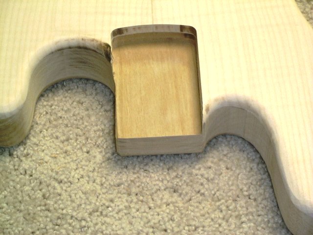

jongor
This is what I'm shooting for
But the radius has to be 1/2".
I'm doing this as an exercise (and fun!) to have a body milled by a local CNC guy.
I don't have any of the tools/equipment required to build a bass and would like learn about cnc/cad interface.

SEANT
The radius can be 1/2" but will not be the result of a Fillet command. The fillet processing for solids can not account for a surface that would self intersect. Surface modeling techniques may help, but they tend to be more involved than just picking the edge of a solid.
Let me see if I can work up a sample.

SEANT
The previous upload is the fillet as a surface. It's pretty good, though the pure 1/2" radius breaks down a little bit. Maintaining fidelity would probably make the file even larger.
Here is the fillet surface incorporated into a solid.
BodyViaSurf2.zip

SEANT
If you look at the BodyViaSurf file you will see the Arcs and Paths I used as construction geometry. Those were lofted to create the surfaces. The surfaces were used (along with some not shown Planar Surfaces) with the Sculpt command to create the Solid.
