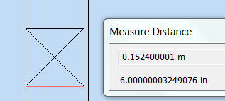

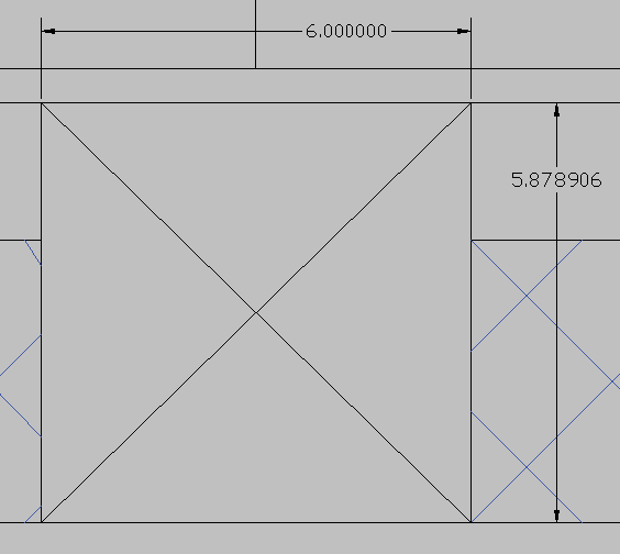

JD Mather Posted September 2, 2013 Posted September 2, 2013 I search around the block to see if I could find some logical reference and this is the only thing I found in my non-exhaustive search. (actually I checked it out to 8 decimal places, only 6 shown) got a little more curious and found one wall (across from Entrance) where it is perfect 6" square. This leads me to believe inches and uniformly scaled. But that doesn't explain all the other dimensions. I would expect to find some uniformity in inch or metric (with conversion). I start to wonder if building units (and by units in this context I mean standard parts) in Japan are as screwed up as the US system. Or did the designer simply not use standard building units. In my non-exhaustive search I did not find any dimensions that would have what I would consider logic metric equivalents in a design. (example - I would expect to find nice even distances like 1.5m or similar when allowed for units conversion) With that those perfect 6x6 squares in one wall - how can I come to conclusion of a non-uniform scaling mistake? Quote

JD Mather Posted September 2, 2013 Posted September 2, 2013 ...Basically I'm trying to scale it at 6.85 x 11 meters so that it will be accurate. How are you determining that it is not accurate now? All I need is one reference dimension (two would be best, one horizontal and one vertical) of some known dimension to calculate the scale. But I don't see anything to use as reference and the perfect 6x6 would lead me to believe that it is already accurate. Well, I took it out a few more decimal places and it isn't perfect 6x6 inches, but what do you think that should be in metric? Quote
