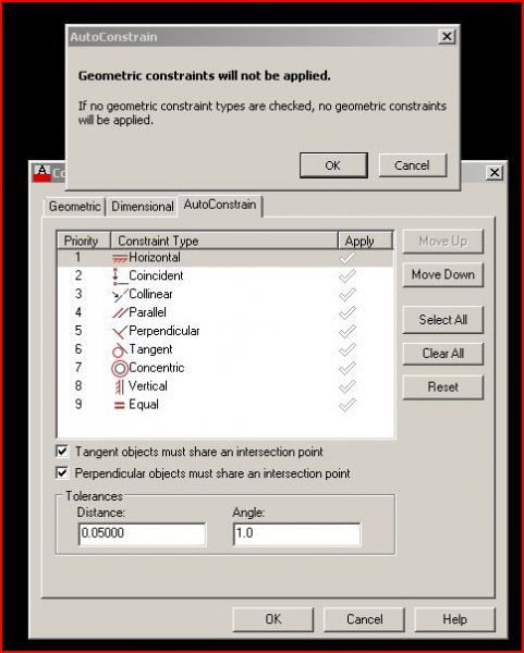

Dadgad
I have never taken the time to learn to use them properly.
Try right clicking on the icon where you turned them off,
select SETTINGS, and try to turn them off there.
Look at all 3 of the constraints tabs.

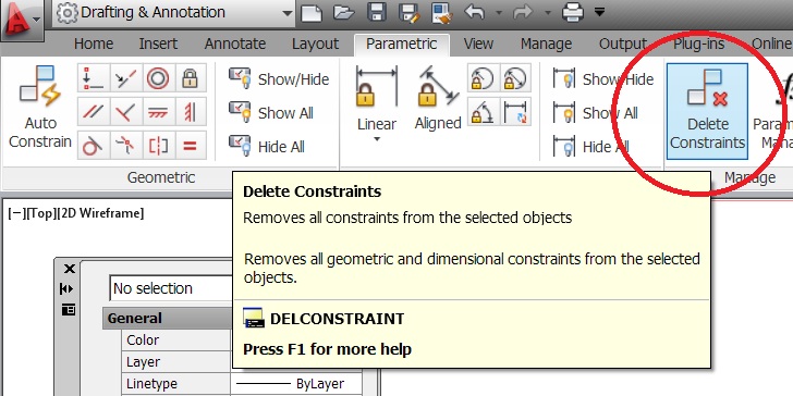

delconstraint > all

Dadgad
delconstraint > all
[attach=config]43850[/attach]
Well done nestly, I should have thought to take a look at the ribbon, instead of just perusing my SYSVDLG. :beer:
