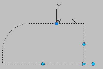

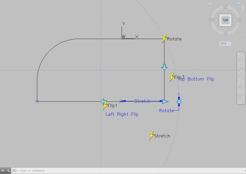

Sadly, DWG files will not attach. I can browse for the file and click upload but nothing happens. The best I can do is:

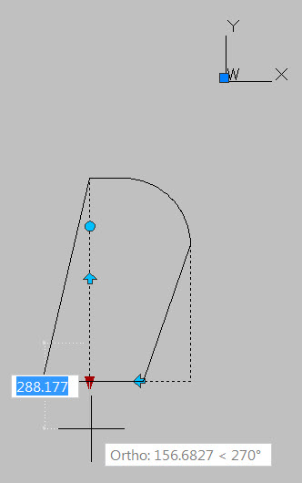

This is the block (it's pretty simple but I am just experimenting). It has two flips and a stretch all of which work okay then I test them:

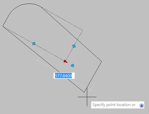

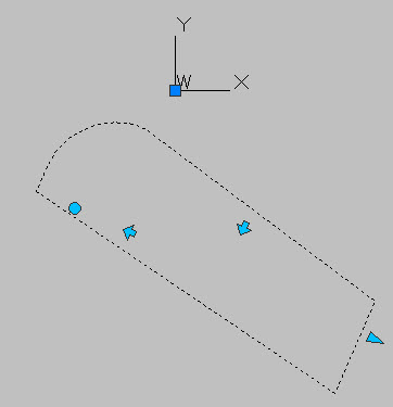

But when I use the rotation, things go haywire:
Stretch and flip give the strangest results.

Create the Stretches first, then create the Flips and include EVERYTHING in the Flip Actions, lastly create the Rotation and include EVERYTHING in the Rotation Action.

The base point of the original block does not move.
After rotation Stretch goes haywire.

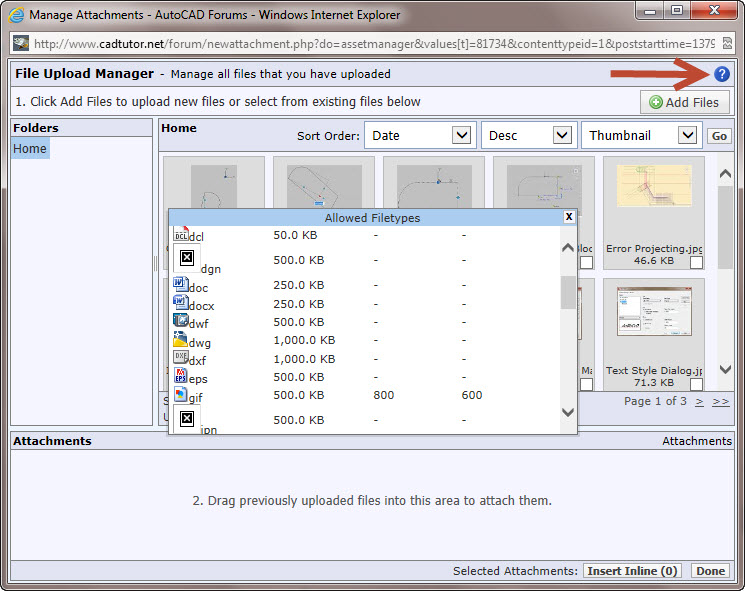

Here are the file type attachment limits for upload to CADTutor.

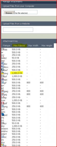

And here is where I found it - right under my nose.
Why don't I stop and think why people make screen widgets with buttons with question marks on them?
I must be getting dafter in my old age:x!

Well, I removed all the parameters and actions and re-inserted all of them. Everything worked fine until the Rotation. Then I still get strange results.
I uninstalled and re-installed Rotation this time typing in in all when asked to select objects. Same, same.
Got madder and reinstalled AutoCAD 2014. Tried again. Same, same. :ouch:
The recycled drawing is attached if anyone's interested.
Note that the Flips haven't rotated.

I have used a crossing window and the word all (at separate times).
In the insertion of the flip Top to Bottom (the first one in this attempt) I used all and got:
12 found 2 not in current space
The arrow doesn't move when I test it. I tried to select objects again using crossing window selection and got:
11 found
Then I tried to insert flip side to side (YouTube =>
That works okay but the top-to-bottom arrow still doesn't move, and the distortion is still there.

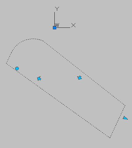

Attached rotate with select objects => all got:
18 found 2 not in current space.
