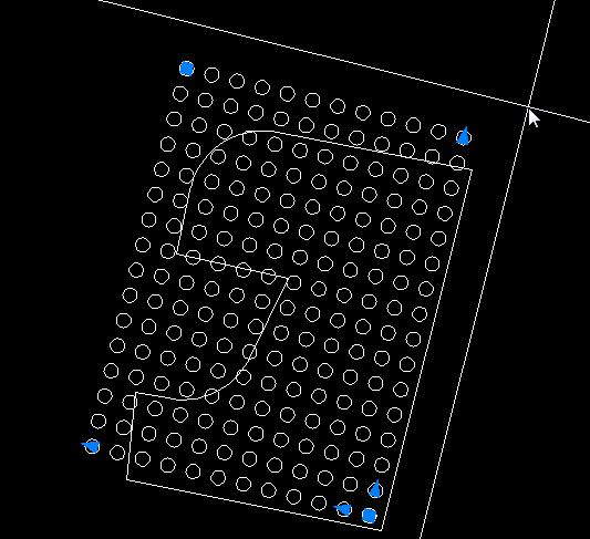

JayVee Posted October 9, 2013 Posted October 9, 2013 I'd like to create a line/lines that would represent nail-heads, spaced a cm or 1/2" apart. In other words, have a few different layers that are a variety of what appear to be decorative nail-heads. I'd draw shapes & lines with any default line, but when the time comes, I could turn specific lines into nail-heads. Any place to download these, or how can I create them, so they'll be an option in my Layers? Quote
Tuns Posted October 9, 2013 Posted October 9, 2013 Have you tried using the array command? Just draw one nail head and array it. Quote
ReMark Posted October 9, 2013 Posted October 9, 2013 You want a custom linetype that looks like a decorative nail head? Maybe you could ask someone who has full AutoCAD to use the MKSHAPE and MKLTYPE commands to create one for you. Post an image of what you would want your custom linetype to look like. How about creating a dynamic block instead? As it stretches more nail heads are displayed. Would that work? Quote

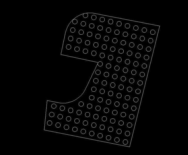

BIGAL Posted October 18, 2013 Posted October 18, 2013 Nails heads along a line, arc, pline etc just use Divide and use the Block option for multiples need a lisp etc. Nails in a polygon use array first then use "Cookiecutter.lsp" to remove those outside. Quote
JayVee Posted October 18, 2013 Author Posted October 18, 2013 None of this is working out to the way I was hoping. For the application I'm thinking of, I believe I need to create a custom Linetype, that represents (or even better, actually looks like) decorative nails. What determines the diameter of the dots in DOT or DOTX2 Linetypes? What determines the the diameter of, and distance between, the circles in the Fenceline circle Linetype? These are already close, conceptually, but ultimately not useable. Quote

JayVee Posted October 18, 2013 Author Posted October 18, 2013 A typical design example is in the file: Nail Design 3. The finished look would be similar to what's seen in the file: Brass Nail Experiment, however, I need ability to add space in-between the nail heads, and alter their shapes. Nail Design3.dwg Brass Nail Experiment.dwg Quote
ReMark Posted October 18, 2013 Posted October 18, 2013 The ability to change spacing and alter shapes, in my opinion, does not lend itself to a single custom linetype. Once again I'd suggest a dynamic block. Quote
