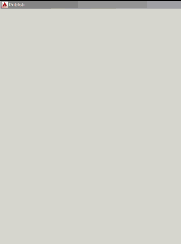

Ok, so I just upgraded to 2015 from 2012, and I'm having a problem with publishing.
I have always had a template file that holds all my page setups, I then import into publish.
So previously, my 42x30 PDF page setup would print to Adobe PDF (like it was a plotter). And when I published, it would prompt me for where I wanted to save the file. When I upgraded to 2015, using PDF as a plotter got weird, and I had to switch to the DWG to PDF function. now, when I publish (even though it IS set to "prompt for file name"), it saves the PDF to the last location I saved to, and uses the name of whatever file I happen to have open.
This is KILLING me. Any suggestions?

nestly
Selecting Publish to PDF?

Mike_Taylor
But will that override the settings in my page setup?
It doesn't, it essentially changes the plotter and matches a page size (or makes a custom page size if nothing matches).
To change location go to publish options and you can select a new location there.

nestly
Nope... it will still use the settings for each layout

resullins
Well, but that's the thing, I shouldn't have to go to location and change it there. And then it will still give it a random name. It's supposed to be prompting me for the file name (and so by default, the location).

steven-g
In the publish dialogue, click on publish options, which opens another dialogue, about the third row down - naming - set that to prompt for name.

resullins
It's already set to prompt for name. That's the problem.
