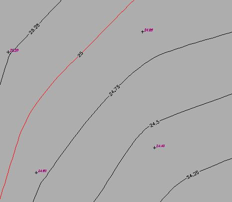

Eoin Posted June 6, 2014 Share Posted June 6, 2014 Working with Trimble Business Centre, I have generated a number of contour lines. When I export the file as a dxf to CAD, my 3d polylines are label-less. Would be very grateful if some one had a lisp which would enable me to just click on the lines in CAD, and the z value would appear opposite the line/ in the line. Alternatively, is it possible to create a line style that would have the lines particular elevation encompassed in the middle of it, similar to the line styles for Watermains which look something like ---WM--- etc? Quote Link to comment Share on other sites More sharing options...

eldon Posted June 6, 2014 Share Posted June 6, 2014 I have this protected lisp, saved from a very long time ago, and I can't remember what the programme was called. If you can work out how to work it, it will produce results like this, but your contours MUST be in 3D. CIV00029.LSP Quote Link to comment Share on other sites More sharing options...
Eoin Posted June 6, 2014 Author Share Posted June 6, 2014 thats exactly the effect I am after Eldon. I made a mistake in my OP too, namely my contours are not 3d polylines, but ordinary polylines with an elevation set Quote Link to comment Share on other sites More sharing options...
eldon Posted June 6, 2014 Share Posted June 6, 2014 I understand contours to be ordinary polylines, but with the appropriate z value. So the lisp should work for you. Quote Link to comment Share on other sites More sharing options...
Eoin Posted June 6, 2014 Author Share Posted June 6, 2014 I understand contours to be ordinary polylines, but with the appropriate z value. So the lisp should work for you. any idea what the command prompt might be???? Quote Link to comment Share on other sites More sharing options...

eldon Posted June 6, 2014 Share Posted June 6, 2014 If you try to load it manually, i.e. type (load "civ00029") the command line reports an error. I think that this is because it is trying to confirm a dongle is there. Ignore that message and type civ00029, and the routine starts. Try the options to make the text face the right way up (facing up the slope). Quote Link to comment Share on other sites More sharing options...
