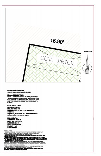

6655321CAD Posted June 18, 2014 Share Posted June 18, 2014 Hello, So, here's the scoop: I'm drafting a property survey, obviously beginning in 1:1 scale. Now, this has to fit on a predefined viewport which rests on an 11 x 17 sheet. The only way I can get it to fit is by scaling the drawing to 1:30 or 1:20 scale within model space. Any clues as to how this can be done? A million thanks in advance! Cheers! Quote Link to comment Share on other sites More sharing options...

6655321CAD Posted June 18, 2014 Author Share Posted June 18, 2014 As a matter of fact, it is a metric scale. I try and put it at 1:30 in paperspace and its huge....... I'm gonna try and put some screenshots up to better illustrate. Quote Link to comment Share on other sites More sharing options...

6655321CAD Posted June 18, 2014 Author Share Posted June 18, 2014 So, here's a jpg of the pdf of my paperspace. As you can all see, the drawing scale is huge, and will not fit inside the viewport. Suggestions and solutions would be greatly appreciated. Quote Link to comment Share on other sites More sharing options...
rkent Posted June 18, 2014 Share Posted June 18, 2014 You are mixing imperial title block sizes with metric drawings. I say again for the third time, you must have a properly sized metric title block. Quote Link to comment Share on other sites More sharing options...
