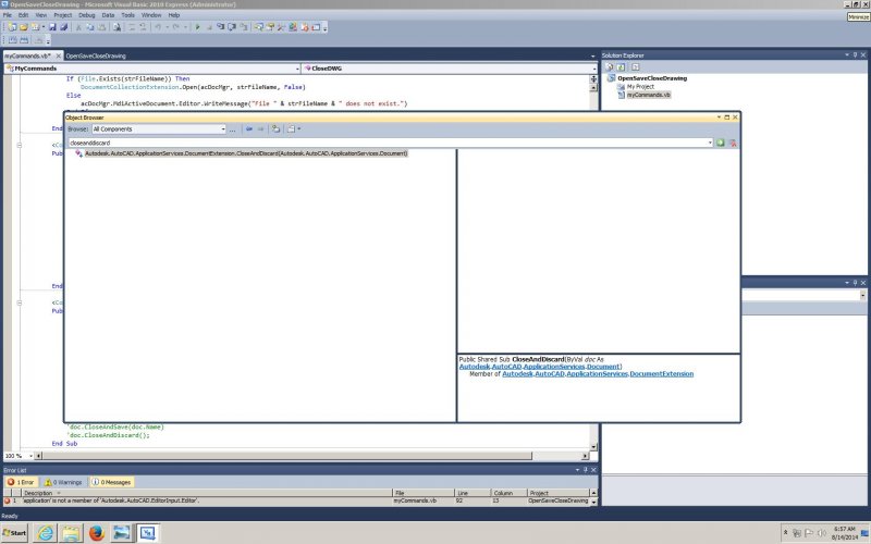

Blackbox, I looked your video link last night and notice that it is in C sharp.
To answer your questions
I don't know about extension methods are so I can't answer your question.
I searched "Close and Discard" in the object browser and got the attached result.
You said the the object browser is my friend. Ok how do I interpert my friend.
So how do I interpret and produce the code I want from the result I have in he attached
file?

That may work fine for you... But again, CloseAndDiscard() is an Extension Method to the Document Class:

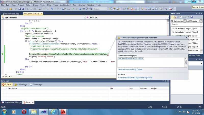

I took put DocumentExtension.CloseAndDiscard(acDocMgr.MdiActiveDocument) in a drawing open/close
program loop.
I get the error:
"Check the Error Code property of the exception to determine HR Result returned by Com object"
This error occurs when my program gets to the statement
What is that error about and how do I solve this one?
Thank you,
I used your C sharp Code and VB intellisence to figure out my code but you said VB object browser is my friend.
Is there any good beginner documents on learning AutoCAD VB.net object browser?
I say that Object Browser (OB) is your friend, because it is the key to your understanding the Object Model (and the Framework generally). It is impossible to memorize everything that the Framework provides, such as each-and-every-single-possible Overload, etc.
Put simply, anything that can take a partial string and query the entirety of the Framework, and all assembly references for you, is most definitely your friend.
Intellisense is a cornerstone of .NET development, as you can see in what feels like real-time what Properties, Methods, and Events are exposed to a given Type. This is useful in determining exactly what is (or sometimes what is not) available to the Type you're working at that moment.
This stuff seems somewhat overwhelming. I need a practical VB.net information for the AutoCAD user so I can start learning
and sorting out this stuff.
Being completely honest, as someone who's still very much a student of .NET development... It _is_ overwhelming... At first.
There's a reason why quality .NET development books frequently near +/- 2,000 page size, and a beginner is often reasonably informed that it will take them a year to become adept at .NET development concepts, IDE, and debugging. It's a challenge, that is often rewarding, and is incredibly powerful as compared to other lower level languages, but easy is not an adjective I'd every use to describe .NET development.
Regurgitating the advice that was given me a year or two ago... Start teaching yourself how to develop for Windows, Forms, WPF, perhaps even a dabble in VSTO, and browser applications... Then, come back and start digging through AutoCAD's .NET API, which is a beast unto itself.
Moving forward, in whichever direction you decide to go, just identify something that interests you (something fun if possible), and start reading everything you can on the topic of how to develop that. Code, and code, and code some more. Break it, and figure out what's wrong, and then learn how to fix it... It's the only way you're going to become proficient... And after you've seen some of the benefits of having done so, you'll be glad you did.
HTH :beer:

.NET Development rule #82376 - Read up on Try, Catch, Finally.
Where are you calling close and are in application context?
Which can be set with CommandFlags.Session attribute
<CommandMethod("Command", CommandFlags.Session)>
The code needs to be ran in the context of the application instead of the document as default.
If ran in the document context the method used to close the document is trying to run inside a document that you just made no longer exist.
