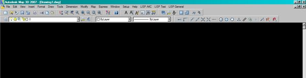

I am a command line person so only have a couple of toolbars showing - mostly for our "special" routines such as export all text off one layer and our revison cloud routine. In general I don't use that many commands anyway. I double click a lot though.

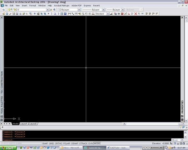

I have Osnaps on the "F" keys which again is a bit easier now with the Accelerator keys, instead of having to delve into ANSI.SYS.
I have three pet lisp shorties which I seem to use frquently - SCL (set current layer), CTCL (change to currrent layer) and CHOL (change object layer).
The less the mouse has to travel, the quicker it is to draw. So keyboard entry for commands means that the crosshairs stay where the action is, instead of having to race around finding and then picking buttons.
I have noticed however that the newer the version of autocad you learn on the more buttons and menu's the drafter uses. I use about 50/50 but the younger drafters clutter their screens with buttons while the old farts have a 19" monitor and 18.75" of drafting space.
YEP, I have one row of buttons an no command line, the boss has no buttons and a 2 line command line showing. Everybody else has a postage stamp screen and takes forever to get to a simple command.
When we upgraded to 2006 we had a trainer in (not sure he knew any more than us) and it was fun beating him to do the commands, him navigating numerous levels of menu and us just typing the command.
