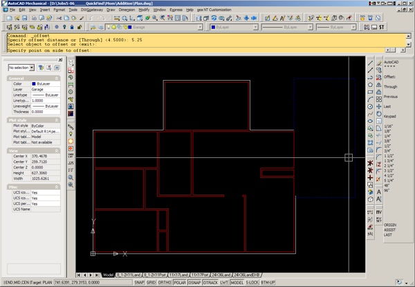

Lets see who all participates. Post up anything regarding your own personal setup in AutoCAD, mainly alterations to the PGP File, any Toolbars/Tool Palettes, or even post up screenshots of your Workspace. try to show true customization, refrain from the AutoCAD defaults, and even give reasons of why you chose the customized object/commands. I'll start....
Altered Keyboard Commands:
1st off, my right click is used as Enter.
C - COPY
CR - CIRCLE
V - LINEAR DIM
VV - QLEADER
BB - BREAK
MN - MIRRER
Q - MATCH PROPERTIES
REF - REFEDIT
RER - RECTANGLE
T - TRIM
X - EXTEND
XX - EXPLODE
S - STRETCH
D - DISTANCE
I use these commands a lot, and so i've trimmed them down to one or two key commands, which makes my left hand stay put on one side of the keyboard. i can get going pretty fast sometimes... :lol:
