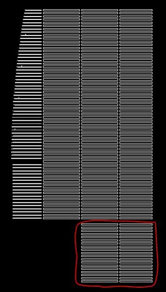

As i understand making the drawing smaller you use "block" so I can make it much more smaller by making a whole facade drawing a block and not just profiles?
I think you are missing the point of using a block. At least one of the blocks you exploded contained almost 300 separate entities. I might not stubbornly disagree with you if it only contained three entities although it is usually not a good practice, as RobDraw mentioned, to start exploding blocks indiscriminately.
Take a good look at your drawing. Those extrusions that used to be blocks, and were subsequently exploded, are so small compared to the remainder of the drawing they are easily lost within the context of the drawing.
Can blocks be used for an assembly or making a facade? Yes.
Not quite, by making a block of one of the profiles that has 300 parts and then copying that to 100 different places, it means you have 300 entities in one block and then 100 references to that block, which would reduce your file size, by making 30 000 entities into a big block it wouldn't reduce the size.

The objects circled in red are a block named LOUVER BL. Similar objects above are all comprised of separate lines. That is to say each and every rectangle consists of four individual lines. Why is that so if a block was available?

Yes, i could have used the rectangle command as well, then that would mean here wasn't 4 individual lines. Can also make each column a block?

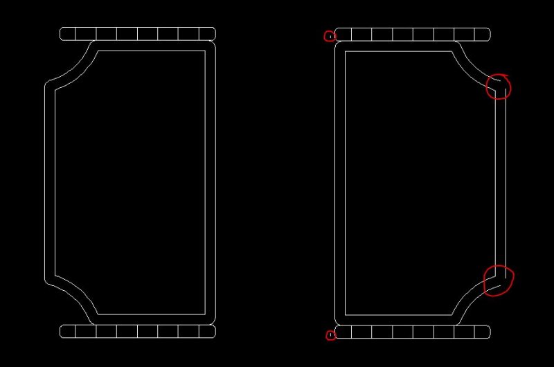

Here is an example from your own drawing where the use of a block would have prevented a couple of problems. Look at the object on the right. Note that as the entities were copied or mirrored the end result left you with two stray line segments and two instances of a missing arc. Multiple that by the number of times that object was used in the drawing.
Sorry, I missed this response earlier.
Yes, you could have used the Rectangle command followed by the Array command. Could each column be made into a block? Yes. But it would probably only be helpful if you were going to reproduce that view, or something similar, more than once. I would say it's up to the user's discretion.
