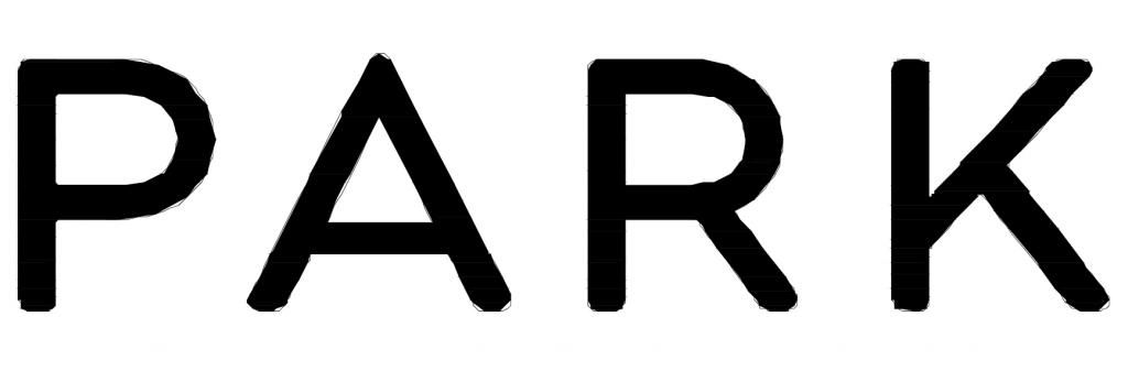

junehe Posted December 30, 2014 Share Posted December 30, 2014 I am using AutoCAD 2015. I use solid hatch to fill in my logo. However, it shows very furry lines around the logo when I export it to pdf file. When I print the file, the logo looks fine. Just when I review it in pdf on computer, it looks really bad. I need to send the drawings to clients in digital file. So anyone can help me solve this problem? Thanks a lot!!! I checked every place on Internet to solve this problem but without any luck. I will be waiting for answers. Please see below attachment to see the bad effect of the logos in pdf. Quote Link to comment Share on other sites More sharing options...

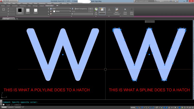

Dana W Posted January 6, 2015 Share Posted January 6, 2015 It is the splines for one thing. They are very rough, with non-tangent radii, and reverse curves. Look at the screen shot. Only the hatches are selected, not the underlying linework. The other thing is that there is a limit to what the pdf program can do with a pixel. It will not color a space smaller than one pixel. There is also a pdf attached, and the modified copy of your dwg file. I changed the hatch color because the BLACK ones were hard to find. ware logo-Layout1.pdf ware logo.dwg Quote Link to comment Share on other sites More sharing options...

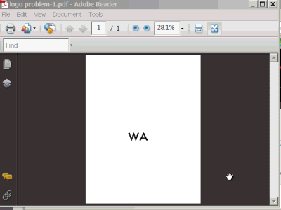

junehe Posted January 7, 2015 Author Share Posted January 7, 2015 Hey, I think this logo might present my issue with the problem better. Please see the attachments. When I print it out, everything looks ok. When people view it in pdf, it looks terrible.Thank you! logo problem.dwg Thank you! logo problem.pdf Quote Link to comment Share on other sites More sharing options...
