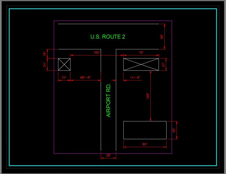

So here is a very simple example using the dimensions you previously stated in your first post.
The islands are drawn in model space at full size.
The paper size I elected to use for this example is 11x17.
The drawing consists of the following layers: 0, Islands, Border, Dims, and VPorts. Note that the layer VPorts (my shorthand for ViewPorts) is set not to print. It will display onscreen but will not print out.
The dimensions were placed in the layout not in model space.
The viewport scale is set at 1"=20' meaning 1 paper unit = 240 drawing units. If I had gone with an 18x24 paper size I could have set the scale at 1"=10'.
drawing was saved in 2010 file format so you should have no trouble opening it.
GasStaLayout.dwg

I am sure I am doing numerous things wrong here, this is only my second drawing. I will upload it now, thanks guys.
Brad State 67.dwg
Any feedback about any part of the drawing, scale, layout, absolutely anything is greatly appreciated!!! I'm just a noob trying to learn!
You used Decimal units which translates to decimal inches. The example I gave you used Engineering units which translates to feet and decimal inches.
In your drawing the island on the left measures 48x48. The one on the right measures 48x70. There is a separation distance of 210. In my example the islands are 24 feet square separated by a distance of 105 feet.
Question: Is the island on the left supposed to be 4' square or 48' square?
If the drawing does not have to be printed to scale then you can do it any way you want. It would be the equivalent of hand sketching a layout on a cocktail napkin.
Some of your text and your 105' dimension in your layout is on the Defpoints layer. That is not good because anything on that layer will not print. The layer is created automatically by AutoCAD as soon as you put your first dimension on a drawing. If dimensions aren't used the layer is not created.
Your viewport should be on layer Viewport not on layer 0.
Your islands should be on layer Islands.
The label "Side Street" is currently on layer 0 along with almost all of your geometry (the "building" is on layer Defpoints - not good). I would recommend a separate layer for text.
Does the side street and the state road intersect?
What is the line that goes from the building over to the island on the left represent?
For a drawing as simple as this one placing your text and dimensions in paper space is the easiest thing to do. Once your drawings get more complex and you start using blocks with text and stuff then you will need to start using annotative scales for your text. I used to use 3 or 4 scales for one drawing but it gets confusing so I just use one scale for my blocks in model space and just place the rest of my text in paperspace.

ReMark - I apologize for the miscommunication on my part in my original post. One island is 24' x 24' which is the new island, the other is an existing and I do not have the specs on that one. I just kind of winged that side of it until I could speak with the guy who gave me the project.
I will start using Engineering units instead of Decimal. Thank you for your insight on this.
After seeing the layout, any advice on how to make it look better in the paper space? How would I go about scaling down how large the dimension annotate numbers are?
It looks like you used the default setting of 3/16" for your dimension text height. This can be changed in your dimension style on the Text tab. I'd recommend 3/32" (.0938) to 1/8" (.125) max.
Are you saying that you drew your objects then scaled them up?
Give me the rough numbers you were using for the other island, the width of the roads, and the building if you please.
My rough guess is that if you wanted to produce a drawing like this that was to scale when printed to fit on a 8.5x11 piece of paper you would probably be looking at a scale of 1"=40' or maybe 1"=50'.
I would suggest using engineering units for site plans and architectural units for building plans.

The island on the left should be 24' x 24' so 48' square. I think my issue was that I was tweaking with the scaling and I must have scaled it all up during that process that is why it is all off.
How do I find out what parts of the drawing are on what layer? How do I go about moving them to a different layer? Within the properties of the item?
I will create new layers for text and the streets, I hadn't ever tried using layers before but now I see they are essential.
I am trying to find the guy to tell me if they do intersect, for now I will leave them not intersected and change when I hear back from him. He has given me a real lack of information on some of this.
The line that goes from the building to the new island is underground power for the island and all dispensers. I need to label it power right under the building.
I will adjust the dimension style and see if I can learn how to make all that work, thats a great tip thank you!
The rough numbers I was using for the other island were 30' x 50' originally and as you said I think I messed up everything due to scaling. The roads I just drew lines and copied them with no real dimensions, any advice on what to make those? It is just a regular two lane highway so whatever would look best with what we have going on throughout the rest of the drawing. I did 35'x85' on the building as a rough guess to his cocktail napkin drawing he gave me (you were correct with the napkin joke :))
Thanks again for your help!
If the island is 24' x 24' then it would be, by definition, 24' square.
You can find out what is on each layer in a couple of different ways. One would be via the Layer Properties Manager. Another would be via the Properties palette. A third way, though a bit more involved, would be by using the LIST command.
I would recommend putting any undergound utilities like sewer, water, electrical, gas, storm drains, fiber optic cable either on a single UTILITIES layer or each on their own layer depending on the complexity of the drawing and/or what the purpose of the drawing is supposed to be.
I know there are different types of scales, which scale would I want to change to 1" = 40'? Would that be the annotation scale?
Ah yes, 24' scale, don't mind my lack of knowledge in this whole drawing world lol.
Here is another example but this time I fit everything onto a 8.5x11. BTW...the dashed grey lines are the printing limits. Any object on or outside those lines will not print.
The scale of the above is 1"=40'. Anyone with an engineer's scale could drop it on the drawing, when printed, and scale off distances. I included a number of dimensions that normally might not show up in a drawing of this type just to give you some idea of what one can show on a piece of paper this size and still be printed to a recognizable scale.
The text and dimensions are on their own layers and assigned different colors.

I have NOT used the annotation scaling feature. Why? Because all my dimensions and text have been placed in my layout and NOT in model space. Some people find this approach useful while others shun it completely. Neither one is wrong. I always state that the user test both methods and use the one that works best for their particular situation.
To get the scale(s) I needed I made use of the SCALELISTEDIT command and added the scales 1"=10', 1"=20' and 1"=40' to my list of available scales.
