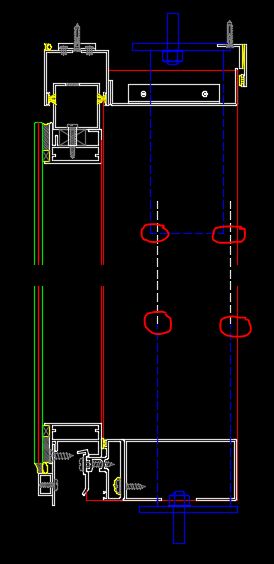

What do you suggest i do? Make of the 3 different types of slab details each a block of and then draw all the vertical lines? That should make the object count less, but wont solve the geometry. And even though i make a block of each, the geometry will still be a mess in the block itself, right?
The geometry would only be "a mess in the block" if someone wasn't paying attention to what they were doing or using blocks by outside sources that were done incorrectly to begin with.
How did you get that right? The big blocks are part of a door. That is suppose to be much smaller. What did you do? Im trying to fix this drawing and its getting ripped apart here.
I checked the block reference properties, Unit factor 25.4 should this be 1:1?
This will mean that our library unit factor is incorrect and also check the block unit its in inches must be metric.
I inserted each block without making any changes to its scale so what you see is what AutoCAD inserted all on its own. If you changed the scale during the insertion process then that would explain why we got different results.

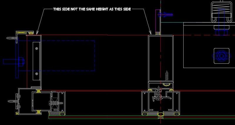

I have seen the height it is slightly out. Try to sort that out as well, just that im struggling with the snaps. It doesn't want to snap correctly and might be because of the axis of the line to the bending plate are different?

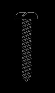

Re: number of objects in drawing. Let's take this nicely detailed screw. We both know it should be inserted as a block. However, in the portion of the drawing you provided for download this screw is comprised of 143 separate objects. How many screws of this type might one find in a complete drawing? Ten? Twenty? Fifty? Now multiple that number times 143. Starts to add up. And I am willing to bet there are other types of screws in the same drawing that are comprised of lines and arcs and are not blocks at all. See what I am getting at? Honestly I am not trying to rip your drawing apart. There is room to make your drawings more efficient and easier to work with while reducing headaches for you and your coworkers.
Yes I understand, your right there. As i come across Countersunk screws i try to replace them with blocks, there is a quite allot. I don't mean it in a bad light, by saying to rip my drawing apart, you have to show me these things so that the drawing can be fixed.

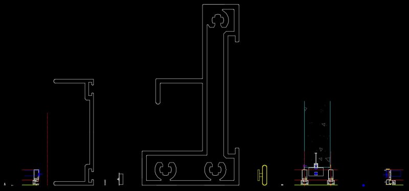

Looks like I have missed a fair bit, I finished work and have just got home, I managed to flatten most of the drawing, off to the right in the rectangle are where most of your problems are, arcs drawn not parallel with the current UCS, as ReMark has been pointing out these come from the aluminium profile. It appears as though somebody has been exploding blocks at some point in the drawings history. I remember a similar problem you were having last year, is there someone in the office that is doing this, or maybe using a different program to do some of the work.
Anyway here is a link to the drawing all the arc's have been moved 20 000 units to the right if you want to shift them back, but I would look at redrawing those parts. The rest of it is all at Z=0
https://www.dropbox.com/s/dg86jy16hjzcijs/FP019-ShpDwg-Zone%2003.dwg?dl=0
Hi Steven-g, no worries. Great that you came back.:) There are times that we explode an aluminium block to do a cut out. I had a look at your redrawn drawing. Those arch's are part of a bend aluminium plate.
With everything we talked about i start to realizing what could have been used as blocks.
I dug a bit deeper, it looks like the problem is starting with those blocks, are they in-house or do they come from an external source. Or it could be that at some point someone has edited the blocks and their UCS wasn't set to world. If you use a central block library it could be worth getting someone to check all the blocks.
