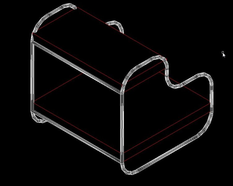

BIGAL Posted April 16, 2015 Share Posted April 16, 2015 My previous rough go a tube bunk bed in reponse to another post. Quote Link to comment Share on other sites More sharing options...
