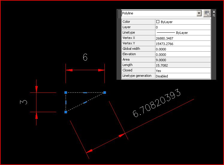

I suggest you 3D Model it, then let the program draw it for you using the VIEWBASE command.
Start by drawing the right triangle with legs of lengths 3 & 6, as shown.
You could just turn on your ORTHO, and draw a POLYLINE of length 6, then move your mouse to the left and click 3 ENTER, then C (for CLOSE) to Close the polyline forming the defining external triangular shape of the top view.
Then you will be well on your way, report back when you have done that.

Dadgad
9 + 36 = 45.
What is the square root of 45?
You are assuming that the keyway is centered in the face, which it is not.
If you do it like I said it will be very easy.
You don't need to enter coordinate points.

Dadgad
You are over thinking it. The triangle I drew took about 10 seconds, should have taken 2 or 3.
If you don't know about ORTHO, hit F8, to turn it on, it will constrain lines drawn to be at right angles.
Do NOT enter the length of the hypotenuse, just because you see a value displayed on my screenshot, use the CLOSE option in the POLYLINE command, as I suggested earlier.
