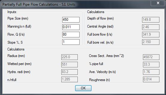

Hi rlx,
Managed to run the program and get the dialog with calculations being done correctly. However If I change data manually they do not get updated. What I get over and over again is the calculations based on initial data. If the data are outside the limits the dialog vanishes. What can be the problem?. The lisp file is attached.

Without knowing what function pipeflow2 or (pipe) is doing , when you call an action_tile you do something with the value but you should also store it.
so : (action_tile "eb_pipesize" "(update_pipesize dia)") , which btw should be 'update_pipesize $value' , passes your value to update_pipesize but it doesn't keep it. One way could be to change your code slightly to (action_tile "eb_pipesize" "(update_pipesize (setq dia $value))")
And with every call to 'aloy_init_dialog' you (re)set dia , man , flo & slo. To prevent that you could use (if (= dia nil)(setq dia "450"))
btw , do you use the lisp editor in autocad? If you select pull down menu 'Debug' and then 'Break on error' you can inspect the point of error. The program pauses and then select pull down menu 'View' and then 'error' trace from where you can see what went wrong.
gr. Rlx

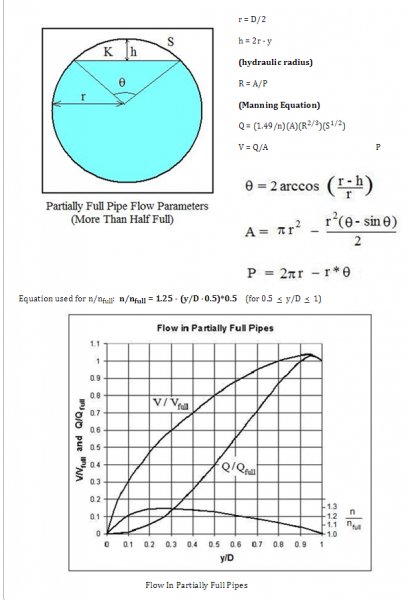

I now understand the isnum function. Thanks for that. I want to include a picture something similar to shown in the attachment. The limit to the level of water inside will be removed and the n/nfull equation will be replaced with a fourth degree polynomial. Is it possible to include it, perhaps a scaled down version?.
Aloy

wow long time i did some math ;-)
To include a picture , mmm , my first choise would be to make a slide from your picture (or you first draw it in autocad and then make a slide) and add an image_tile to your dialog to show it. The other , more professional option would be to use vectors to draw the lines to the image_tile. I know Lee Mac has some pretty impressive examples on his site. I do sometimes use them , last time was in my RlxIso routine to highlite a selected 'cell'.
Anywayz , I'm not sure if lisp has the capabilities to directly show a tif or jpg. But you can use startapp command to lauch a viewer to show your picture.
gr. Rlx
btw , you do mean a static picture / slide because if it has to be dynamic you have no choise but use 'vector_image'.
Sorry to bother you with all these maths, but it is just to explain what comes as a picture. There is no zooming, hence no need of vectors I suppose. I think this is a static picture about the size of the present dialog itself and large enough to be in the autocad screen.
