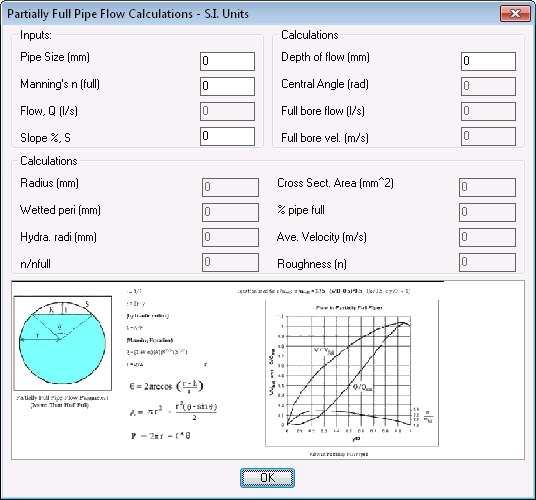

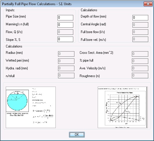

rlx Posted September 27, 2015 Posted September 27, 2015 aloy.lsp aloy.DCL aloy-landscape.zip aloy-portrait.zip aloy-split1.zip aloy-split2.zip Quote

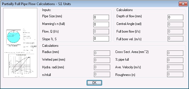

aloy Posted September 28, 2015 Author Posted September 28, 2015 Rlx Can portrait be accommodated in the work space?. The pictures are to be replaced with different ones, but about the same size. Will get back to you soon. Aloy Quote
rlx Posted September 28, 2015 Posted September 28, 2015 RlxCan portrait be accommodated in the work space?. The pictures are to be replaced with different ones, but about the same size. Will get back to you soon. Aloy Hi Aloy , nos problemos , portrait looks best indeed. gr.Rlx Quote
rlx Posted September 28, 2015 Posted September 28, 2015 Hi Aloy, updated dcl & lsp. Program will search for a aloy.sld and if not present it will draw a red cross. gr. Rlx aloy.DCL aloy.lsp Quote
aloy Posted September 28, 2015 Author Posted September 28, 2015 Hi Rlx, The slide doesn't come up in the dialog. I tried to increase the with and also tried with different aspect ratios but no luck. Aloy Quote
rlx Posted September 28, 2015 Posted September 28, 2015 Hi Rlx,The slide doesn't come up in the dialog. I tried to increase the with and also tried with different aspect ratios but no luck. Aloy Are all the files , aloy.lsp , aloy.dcl and aloy.sld in the same folder? and is that folder in your support path? Maybe try to make your own slide. Does (findfile "aloy.sld") find the slide? gr. Rlx Quote

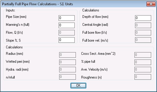

aloy Posted September 28, 2015 Author Posted September 28, 2015 I changed the name of the file in lisp to 'aloy-portrait' and ran with all files in C:\temp\lisp as was advised previously before my previous post. The picture did not appear in the dialog. (princ sld) returned nil when defined inside aloy-init-dialog. The red cross too did not appear. Quote
rlx Posted September 29, 2015 Posted September 29, 2015 I changed the name of the file in lisp to 'aloy-portrait' and ran with all files in C:\temp\lisp as was advised previously before my previous post. The picture did not appear in the dialog. (princ sld) returned nil when defined inside aloy-init-dialog. The red cross too did not appear. and you are using the code / parts of the code from my post #69??? You probably don't wanna rewrite your own code each time but I assume the dcl is not the problem cause you can use the latest posted but in case of the lsp the aloy_init_dialog gets one extra line for the image. (if (setq sld (findfile "aloy.sld"))(showslide sld "i_graph")(noslide "i_graph")) and add sld to your local var's and you have to add functions showslide & noslide to your own aloy.lsp to. The lsp posted is more or less just for testing / showing how to display the image. When you just use vslide in autocad , you can view the slide without problems? ah , now I get it 'changed the name of the file in lisp to 'aloy-portrait' No just change the name to aloy.sld. It seemed logical to me to have aloy.lsp , aloy.dcl and aloy.sld. My mistake for not communicating that more clearly , sorry for that... but just as I replied in post #73 I wrote : btw I did mention : 'updated dcl & lsp. Program will search for a aloy.sld and if not present it will draw a red cross' I also change the image button's name in the dcl file to "i_graph" assuming you would be using the latest dcl I posted. Hope this clears things up... gr. Rlx Quote
aloy Posted September 29, 2015 Author Posted September 29, 2015 vlide shows an image covering the full screen, but I suppose the vectors take care of sizing it. However the image is disfigured with letters in text broken. I will change the name to aloy and run again as I do not know what is in the compiled slide. Regards, Aloy Quote
rlx Posted September 29, 2015 Posted September 29, 2015 (edited) vlide shows an image covering the full screen, but I suppose the vectors take care of sizing it. However the image is disfigured with letters in text broken. I will change the name to aloy and run again as I do not know what is in the compiled slide. Regards, Aloy making a slide from a image does that. Making a slide from a vector based drawing gives far better results. They are just for demo as you said you would make a new picture with other or less info on it. The image will be scaled in the dcl file to fit. When you do make a new picture , you can attach it in a drawing , in model space. Then go to paper space and make an mview and make it's shape fit the image and then make a slide (make sure the mview is active at the moment you make the slide). You can also try to make the slide with a black (modelspace) background and a white background to see what gives a better result. Finally you might have to tweek the size and ratio of your image tile in the dcl file to best fit the ratio of your slide. gr. Rlx Edited September 29, 2015 by rlx Quote
