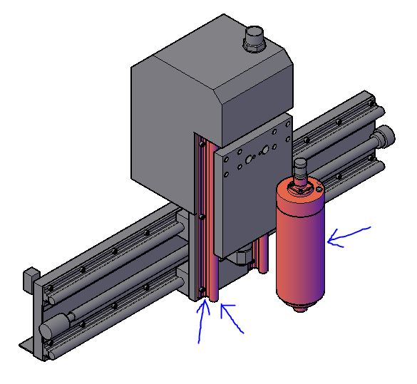

Isham_Dean21 Posted March 27, 2016 Share Posted March 27, 2016 i'm having a similar problem. i 3d modeled my cnc machine over the last few nights out of boredom. everytime i hit save, close autocad 2015, fire it up the next night, some of my parts move WAY out in model space. however, when you click on them, it shows the grips in the correct place. so the 3d model is blown out several hundred feet but the "wireframe" and grips are in correct place. what the crap?! it's been doing that every single day when i fire it back up. it's usually only 3 or 4 parts but this time is a ton. i'm the "clean freak" when it comes to drawings. i don't have any layers in there that don't need to be or whatever. always have clean drawings but this is just crazy. any thoughts anyone?? Quote Link to comment Share on other sites More sharing options...

Isham_Dean21 Posted March 28, 2016 Share Posted March 28, 2016 i stripped crap out to make it able to upload on here...you'll see what i mean Problems.dwg Quote Link to comment Share on other sites More sharing options...
ReMark Posted March 28, 2016 Share Posted March 28, 2016 (edited) OK...now that I have the drawing open I see if I click on some of the geometry off to the left the grips appear in the geometry to the right which I admit is a bit strange. As a test I managed to reunite some of the 3D parts with their grips, saved, then reopened the drawing. The objects did not change position. Edited March 28, 2016 by ReMark Quote Link to comment Share on other sites More sharing options...
ReMark Posted March 28, 2016 Share Posted March 28, 2016 (edited) I may have come across something of interest to you. I found an article at the cadtobim website dated 10/22/15 referencing your exact problem which the author attributes to a bug in AutoCAD (not sure how far back the bug goes). He also mentions a dvb procedure that can correct the problem without having to edit each 3D solid object in one's drawing individually. You can read more about it by following the link below. Download the grips_solid_corector.dvb file. I have not tested this myself and cannot vouch for the efficacy of the fix. http://www.cadtobim.com/autocad-specialist/-displaced-solid-objects-and-grip-problem Note that Microsoft Visual Basic is required to run the .dvb file. At some point in time this used to be installed right along with AutoCAD but AutoDesk ceased providing it meaning users had to go to their website to download a copy. Update: So I visited the AutoDesk website looking for VBA but the only versions avail for download were for AutoCAD 2014 through 2017. I think this means AutoCAD 2013 users either had it installed during the installation process or it is available on the installation media. One last thing. I see you are using AutoCAD 2013. Is the latest service pack installed? Edited March 28, 2016 by ReMark Quote Link to comment Share on other sites More sharing options...

ReMark Posted March 28, 2016 Share Posted March 28, 2016 I stumbled upon the method I used to reunite objects/grips before I found the article I provided the link to. You should update you profile to reflect you are using 2015. Once you download MS Visual Basic and get it installed return to AutoCAD and run the VBAMAN command to load the .dvb file. Quote Link to comment Share on other sites More sharing options...
