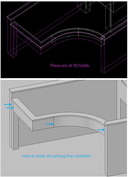

3D Solids after Union
dreamer

Why? Will the "lines" be invisible when the piece of furniture is built?
Share this post
Link to post
SLW210
Is there a slight misalignment in the pieces?
Post the .dwg.

ReMark
The one on the far left can be made to disappear if you union the vertical piece to the "L".

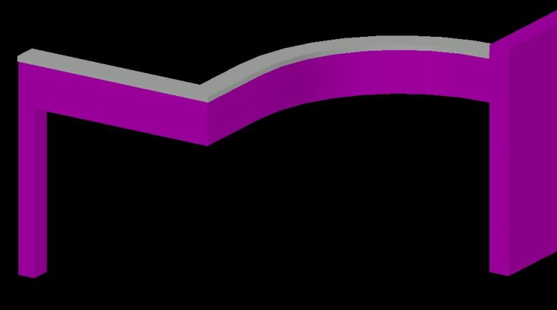

rkent
Try setting VSEDGES to 0.
Share this post
Link to post

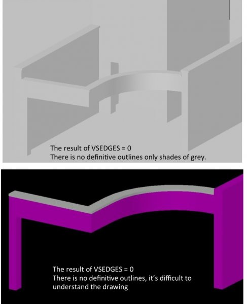

dreamer

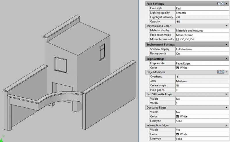

Thanks rKent's suggestion changed VSEDGES to 0, but then all outlines invisible only panes with different shade of grey.
I have tried also make changes to the Properties without success.
There must be something I missed.

ReMark
What are you referring to by the words "outlines" and "panes"? Are you talking about the flat two dimensional windows? You do realize that the majority of the inside of your building is one big solid and that the windows are basically drawn on the front and side faces. You cannot peer into them and see the building's interior. Nothing about the windows is really 3D.
rkent's suggestion does work.

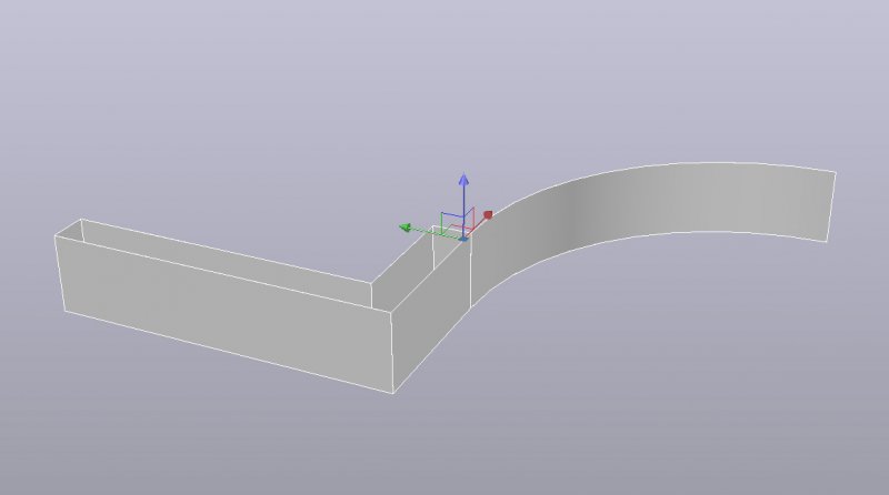

Cad64
There is something strange going on with your model. When I isolate that curved piece, the image below is what I see. This is all one piece and is listed as a 3D Solid. I'm not sure what's happening here, but you might want to reconstruct that piece.

rkent
If you create that view using VIEWBASE commands, then you can freeze the layer MD_Hidden_Narrow and it won't show in the views in PS. HTH

dreamer
That curved piece is modeled by Polysolid because of failure Extrude from Polyline, I used other route to get me the model. But it still can't explain why the line between the far left wall and the shorter pillar is visible.
rkent. Sorry that I do know understand your procedure.
ReMark. My problem is the visible lines after 3D Solids union not the window lines.
