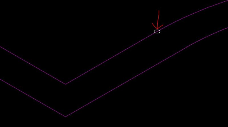

Nice explanation but the OP has bigger problems than what lines are or are not visible.
Your geometry has overlapping endpoints between a straight line segment and the arc it is supposed to connect to. The overlap measures 0.02026863. And this is where it is located.
One other thing. I'm not sure you have a true ninety angle for your arcs which may be throwing things off as well. Did you construct the profile while in an isometric view and perhaps make an erroneous pick?
