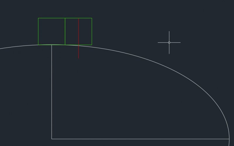

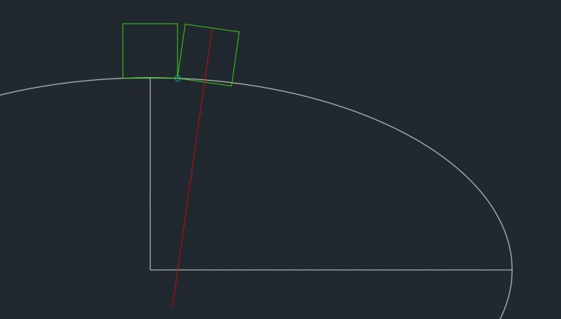

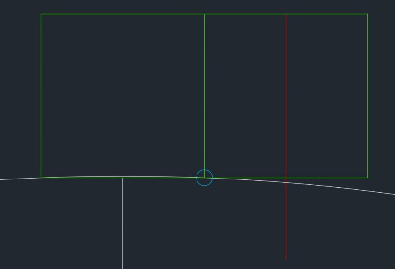

oftenly Posted February 14, 2017 Share Posted February 14, 2017 Hey guys, another quick one here. I'm trying to rotate objects around an ellipse. Here's a quick look at what I'm trying to do: I want to rotate that second box on the right so that it faces the center of the ellipse, yet remains connected to the first box at the front corner. Here's a close up: Basically I want to rotate around the point indicated by the blue circle, and end up where the red line is lined up with the ellipse's center. For the life of me, I can't get this to work. I start the ROTATE command, and select that point. Then I hit R for reference, then select two points on the red line, then select the center of the ellipse, but for some reason it only rotates enough as if the blue point were the reference point. In other words, this is what I get: Am I just totally borking the ROTATE command? Or is this even possible to do? Thanks for the help. Quote Link to comment Share on other sites More sharing options...
ReMark Posted February 14, 2017 Share Posted February 14, 2017 Stop giving yourself a headache and download Lee Mac's custom lisp routine called Align Objects to Curve. The demo he provides will give you some idea of how it works. First, however, read the program description. http://lee-mac.com/objectalign.html Quote Link to comment Share on other sites More sharing options...

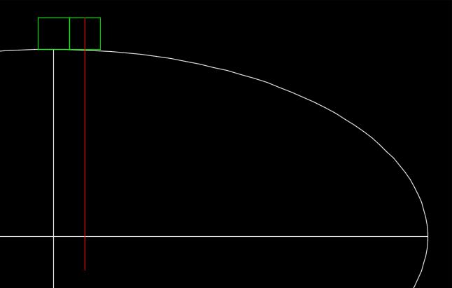

ReMark Posted February 14, 2017 Share Posted February 14, 2017 This is my attempt. First image is the "before" rotate. Second image is "after" rotate. Is the second image the result you are looking for? Quote Link to comment Share on other sites More sharing options...
oftenly Posted February 14, 2017 Author Share Posted February 14, 2017 Yep, that's perfect, although after I made the thread I realized that's not exactly what I wanted to begin with. What I really want is to align the "front" face of the green box with the ellipse, which is just a matter of drawing a circle and rotating the box so that the other "front" corner intersects the ellipse. So you end up with an circular segment's worth of the green box that's inside the ellipse, but that's OK. But, this is more easily done with that LISP you posted earlier. Quote Link to comment Share on other sites More sharing options...

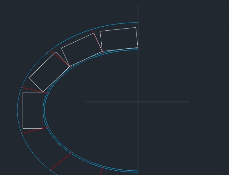

oftenly Posted February 14, 2017 Author Share Posted February 14, 2017 Yes, but I'm dealing with a much more sinister one right now. Let me clue you in, for funsies: Basically, this is me trying to arrange some casework (white rectangles) underneath an elliptical countertop. I'm trying to get 7 more-or-less equal-width boxes in this area, with a consistent maximum setback of 1-1/2"... and I think I'm about to cry. My geometry skills are half-decent (I can fumble my way around a trig function), but this seems like a whole different level. Do you have any ideas about how this might be done easily? Right now I'm rotating and resizing the top three boxes by hand, which is totally not ideal. The red lines are from me running the DIVIDE command, although those arc lengths are not equal. Ignore that other horizontal white line off to the right, I don't know what it's doing there. Quote Link to comment Share on other sites More sharing options...

rkent Posted February 14, 2017 Share Posted February 14, 2017 I would work from the outer edge of the counter, figuring how far back the cabinet at 9 o'clock can actually be from the edge of the front of the counter. Offset the ellipse that distance and move the other cabinets two edges to be an equal set back distance from the front. This assumes the aesthetics of the front are more important than the back. Having each cabinet corner set back the same distance from the front will give you a better visual appearance, imo. You have them placed by eye about where they can go, just move the forward and rotate to touch the front offset ellipse. Quote Link to comment Share on other sites More sharing options...

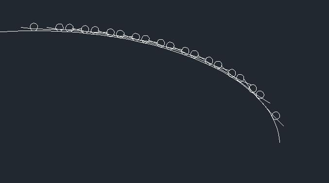

BIGAL Posted February 15, 2017 Share Posted February 15, 2017 Here is a solution for rotating an object in this case a block, aligning to two pts on the object, its based on two points in the block being a fixed distance apart. For any one else interested its for checking vehicles bottoming out. (Defun draw_vehicle ( ) (SETQ ANGBASEE (GETVAR "ANGBASE")) (SETQ ANGDIRR (GETVAR "ANGDIR")) (SETQ LUNITSS (GETVAR "LUNITS")) (SETQ LUPRECC (GETVAR "LUPREC")) (SETQ AUNITSS (GETVAR "AUNITS")) (SETQ AUPRECC (GETVAR "AUPREC")) (setq oldsnap (getvar "osmode")) (SETVAR "LUNITS" 2) (SETVAR "ANGBASE" 0.0) (SETVAR "ANGDIR" 0) (SETVAR "LUPREC" 0) (SETVAR "AUNITS" 3) (SETVAR "AUPREC" 0) (setvar "osmode" 0) (if (tblsearch "Block" "Holden") (princ "Holden") (progn (command "Insert" "p:\\Autodesk\\vba\\holdencar.dwg" "0,0" 1 1 0) (command "erase" "last" "") ) ; progn ) (setq obj (vlax-ename->vla-object (car (entsel "\nPick Pline")))) (setq interval ( getreal "\nEnter spacing m:")) (setq cRad 3.05) (setq startang (* pi 1.5)) (setq endang (/ pi 2.0)) (setq dist 0.0) (setq len (vla-get-length obj)) (setq stpt (vlax-curve-getpointatdist obj interval)) (setq num (+ 1 (fix ( / len interval)))) (repeat num (command "arc" "C" stpt (polar stpt endang crad)(polar stpt startang crad)) (setq objarc (vlax-ename->vla-object (entlast))) (if (= (setq intpt (vlax-invoke obj 'intersectWith objarc acExtendnone)) nil) (setq intpt (vlax-invoke obj 'intersectWith objarc acExtendThisEntity)) ; needed at start ) (vla-delete objarc) (setq ang (angle intpt stpt)) (command "Insert" "Holden" stpt 1 1 ang) ; need ang in radians (setq stpt (vlax-curve-getpointatdist obj (setq dist (+ dist interval)))) ) ; repeat (SETVAR "LUNITS" lunitss) (SETVAR "ANGBASE" angbasee) (SETVAR "ANGDIR" angdirr) (SETVAR "LUPREC" luprecc) (SETVAR "AUNITS" aunitss) (SETVAR "AUPREC" auprecc) (princ) ) ; defun (draw_vehicle) Quote Link to comment Share on other sites More sharing options...
lrm Posted February 15, 2017 Share Posted February 15, 2017 Here's a process that will let you rotate the rectangles so that they are exactly tangent to the ellipse. 1. Create a preliminary 4 vertex closed polyline that roughly approximates the rectangle with your first guess of dimensions. The "rectangle" sohuld not be orthogonal to the WCS 2. Apply dimensional and geometric parametric constraints to force it to be a rectangle. For example: 3. Make 3 or 4 copies of the rectangle and place them off to the side. 4. Apply a vertical constraint to one of the long sides of one of the rectangles and then move it so its midpoint snaps to the end of the ellipse. 5. Move one of the rectangle copies so that its corner snaps to the corner of the vertical rectangle as shown then add a line from the corner and use osnap tan to make it tangent to the ellipse (yellow line). 6. Add a lock constraint to the tangent line. We do not want it move move, we want the rectangle to rotate. 7. Add an angular dimension constraint from the tangent line to the rectangle base as shown (the 4.41° dim). 8. Change the angle dimension to 0.0. The rectangle should rotate to be tangent to the ellipse. 9. Repeat step 5 through 8 for additional rectangles. After you go through this process once you can try new values for the next iteration. Since the rectangles are parametrically driven you can just edit the dimension values. YOu could get more sophisticated with this approach but it is difficult to explain. Lee P.S. The location of the foci of an ellipse is easy to find if you know its semimajor, and semiminor dimensions. a^2 + b^2 = c^2 Quote Link to comment Share on other sites More sharing options...
