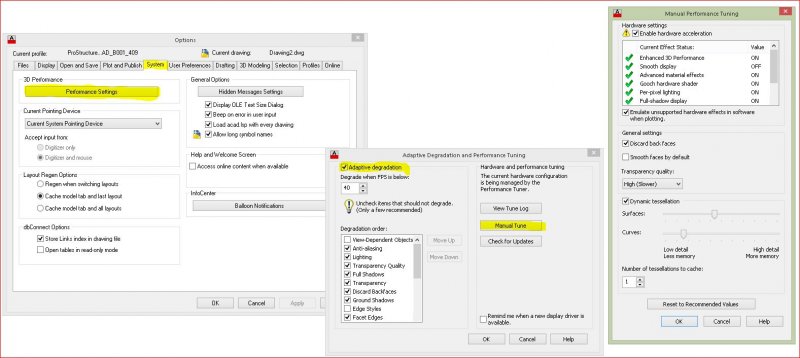

Good day all your clever people. I have installed autocad 2018 and experience a problem that , in 3d modeling, it crashes the moment i try to switch from any view to REALISTIC view. All other 3d views is no problem, but when i click on the realistic view icon, it makes a fatal crash. Also it does the same when i try to open the materials browser.
This is a fresh install and i have tried to repair the install. Everthing else works perfect. The file i am working on was created on my previous version, autocad 2014.
Also, i am using a new laptop now. i7 version 7 processor, 16gig ram, nvidea gtx 950 2gig graphics, direct xi.
I have tried now for hours on the autodesk site forums to look for a solution or a service pack or something, no succes.
Can anyone please help if you had the same problem and managed to solve it???

Have you run the 3DCONFIG command and tried enabling or disabling Hardware Acceleration?

To the OP, I doubt if a 2 gig video processor is going to run easy on realistic. Check your device manager in control panel and see if your NVidia card is even enabled and set as the default video processor. When I bought a laptop a couple years ago with a NVidia gt650 installed, it took me a couple of weeks to realize it was defaulting to the HD4000 on the motherboard rather than the add on card.

If you access it from OPTIONS you can choose to manually configure it, at least that is the case in 2013 Vanilla.
Starting on the SYSTEM tab, as shown in the screenshot.
Hardware Acceleration can be on, but with some non-essential and power zapping functionality turned off.
Adaptive Degradation is also a useful tool, if you feel your FPS is lagging, perhaps under the weight of sofftware functionality which is routinely not utilized.
Adjusting Dynamic tesselation, to reduce memory drain, or turning it off, may also help.

Thanx. I'll make sure it is enabled, didnt even think to check that......

Hardware Acceleration is a double edged sword.
Sounds like a good thing, and it can be, but such is not ALWAYS the case.
There are lots of threads wherein knowledgable forum members, trying to help others, make suggestions along the lines of...
If your Hardware Acceleration is switched off, enable it.
If your Hardware Acceleration is ENABLED, turn it off.
But having it turned on, but tweaked, so as to only enable those functions which are important to you, at any given moment, while minimizing negative impact, might just be the ticket.

2018 is pretty new, did you check to see if there was a newer Graphics Card Driver Available from either Autodesk or Nvidia?
