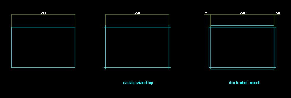

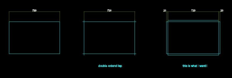

Hi everyone,
I'm assuming this has to have been created somewhere to assist all those people that have to draw panels with tab returns on them, but short of buying a program i cant seem to find a solution!
I have a bunch of polylines, mostly rectangle shaped and not necessarily all with 90 degree corners that need 20mm returns on them with the corners cut out. I've found a lsp to extend the lines by 20mm but then they need to be joined. I've attached a picture of what i'm trying to achieve and also the double extend lisp if that's at all helpful.

A hint offset pline then notch corners, yes a lisp. Ignore image having trouble removing. Its a point square to another pline routine to do notch. Need to have a think. Happy to discuss any others you want as a fee for service.

TRy this if it errors on the last tab let me know I have spent an hour trying to find a hidden character in code or its my pc has a memory problem code works when I run last few lines from command line.

Thanks roy when you look at it yourself can never see the problem. I was doing the last segment twice.
Edited by BIGAL
Hey BigAl,
Thankyou so much!
Its doing exactly as you said, the last side isn't offsetting, i tried putting in the code from Roy but its not working & i don't understand what i'm doing wrong :(
Also the command 'pltabs' doesnt work. The only way i could test it was after installling it, it pops up once then i have to uninstall it and install it again to run the lisp again.
Please excuse my limited knowledge, its super frustrating for me too haha
Claire :)
Sorry I thought I edited the code this line is correct now (repeat (- (length lst) 1) just change in your saved version.

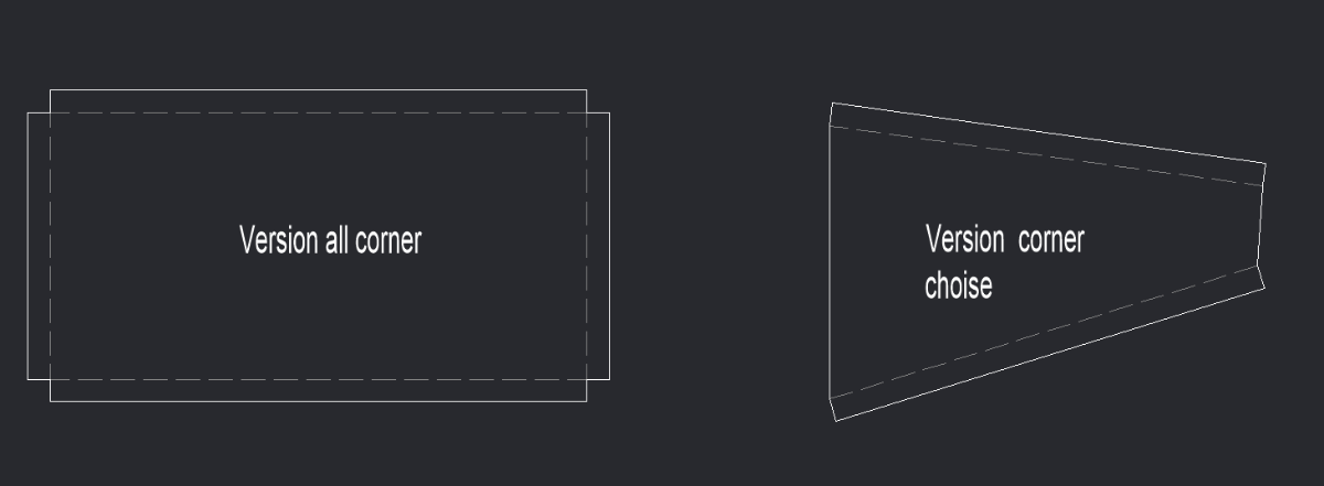

Good morning
lisp very useful thank you
I have a small comment or two if you allow me...
does not work correctly if you make a rectangle from right to left with the rectangle command.
works very well in the other direction and with all the polygons that I have tried.
and could we erase the old polygon and join the lines to obtain a closed polygon according to you?
Pline problem is to do with wether its drawn Clockwise CW or Counter Clockwise CCW, so tabs will go in instead of out.
Will fix code and repost. A easy fix.

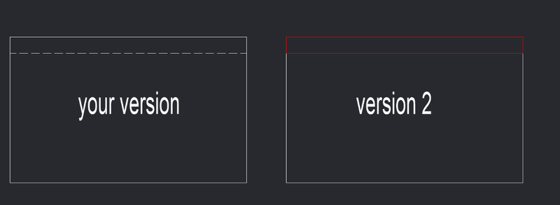

See my post 2 will add the enter sizes dcl, are you metric or imperial.
@DELLA MAGGIORA YANN This sounded like a fun exercise so I wrote my own version. This one should account for the polyline direction and will match the layer of the selected polyline.

Great, it works well.
Is it possible to make the old rectangle or polygon be deleted or dotted in another layer for example and make the polylines created join to make a closed polyline?
Yes - it's possible. Please explain more specifically what you would like to do:

Good morning
I will answer point by point for greater clarity.
1) I wanted the original polyline preserved or not (with a choice why not?)
2(If kept passed on a type of dotted line ( - - - - - - - -) and in a gray color slap.
3) Yes, join all tabs together
What would be fantastic would be to be able to choose the segments that will be shifted. Again with a choice of doing all the segments or one after the other.
let me explain...it would be for the creation of stair treads in folded sheets.
it would help me a lot in my job
This must all be quite complicated, I think.
