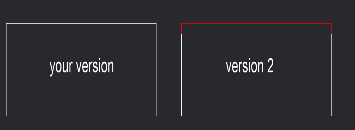

Do you believe it is possible to create the same lisp with the creation of a closed boundary ?
Change this and will be closed.
(command "pline" pt1 pt4 pt3 pt2 "C")
Remove
(command "line" pt1 pt2 "") so no extra line
remove so no dashed line
(vlax-put obj 'Linetype "Dashed")
(vlax-put obj 'Linetypescale 100) ; change as required
