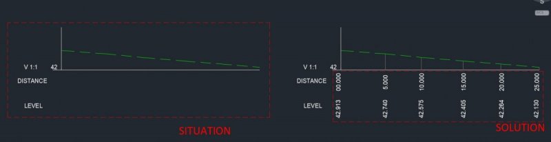

dlanorh Posted August 16, 2019 Share Posted August 16, 2019 Attached is lisp that now handles both options 1 & 2, along with an explanitory drawing. ROAD-SK-TEST-Min-requirements.dwg ODL.lsp 1 Quote Link to comment Share on other sites More sharing options...

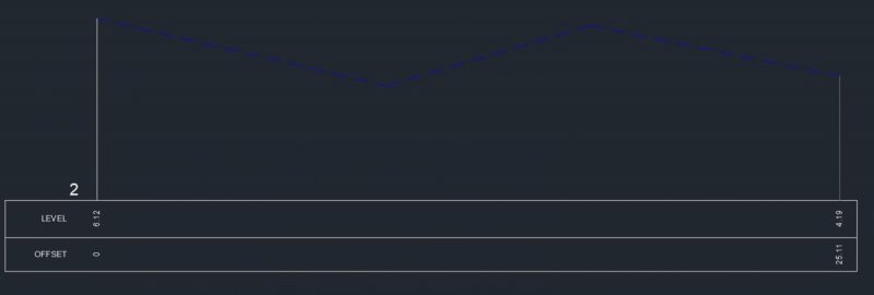

Ish Posted August 17, 2019 Author Share Posted August 17, 2019 (edited) 6 hours ago, dlanorh said: Look at the post above your last one (first post page 2) This does both. Command: AP APPLOAD ODL.lsp successfully loaded. Command: ODL Oops an Error : no function definition: VLA-PUT occurred. -------------------------------------------------------------------------------------------------- I FOUND ABOVE ERROR AFTER APPLOAD LAST ONE ODL.LSP AND NOT GETTING VALUE @ FIX INTERVAL, ONLY START 0.00 AND LAST COMING. (IN MIDDLE NOTHING CAME) SEE ATTACH IMAGE ---------------------------------------------------------------------------------------------------------- FOR CROSS SECTION BELOW ERROR Oops an Error : bad argument type: numberp: nil occurred. THANKS Edited August 17, 2019 by Ish MODIFY Quote Link to comment Share on other sites More sharing options...
Ish Posted August 17, 2019 Author Share Posted August 17, 2019 On 8/16/2019 at 5:08 PM, dlanorh said: Attached is lisp that now handles both options 1 & 2, along with an explanitory drawing. ROAD-SK-TEST-Min-requirements.dwg 73.18 kB · 0 downloads ODL.lsp 11.12 kB · 1 download THIS IS WONDERFUL SIR, LISP 2IN1, Quote Link to comment Share on other sites More sharing options...
dlanorh Posted August 17, 2019 Share Posted August 17, 2019 Attached is corrected lisp, a typo in the create layer if not there condition. ODL.lsp 1 Quote Link to comment Share on other sites More sharing options...
Ish Posted August 18, 2019 Author Share Posted August 18, 2019 (edited) 9 hours ago, dlanorh said: Attached is corrected lisp, a typo in the create layer if not there condition. ODL.lsp 11.12 kB · 1 download finally I get 3 in 1. I must say "Thank you very Very Much " sir You Solve my big problem. From last 10 yrs, I was looking this kind of lisp. Again Thanks a Lot. sir Edited August 18, 2019 by Ish MODIFY Quote Link to comment Share on other sites More sharing options...
