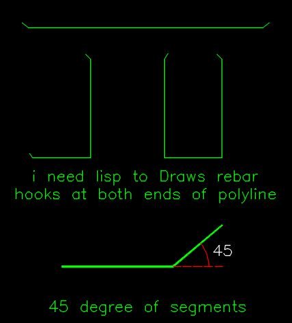

Abdulellah Posted November 24, 2019 Author Posted November 24, 2019 10 minutes ago, Abdulellah said: hello . i am new at this forum can you help me to write lisp . thanks for all worthily efforts -select polyline -ask hook side at start point and it is length and angle (preferd 45 degree ) -ask hook side at end point and it is length and angle (preferd 45 degree )  abdulellah.alattab@gmail.com Quote
BIGAL Posted November 25, 2019 Posted November 25, 2019 (edited) This is a good time to start to learning lisp, without getting to smart about the task you want a extra line either left or right of a pline end.  This would be done using the endpoint and startpoint of a pline, then using the polar command working out a new point adding the line then to the pline.  So a start get the pline vertice points this allows you to work out the pline end segments angles. using polar command draw the new line +45 to the angle ask is it correct direction if not erase and use -45 to the angle.  Ok so some code  (setq plent (entsel "Pick pline")) (if plent (setq co-ord (mapcar 'cdr (vl-remove-if-not '(lambda (x) (= (car x) 10)) (entget (car plent)))))) ; ((156.0 78.0) (307.957959107735 78.0) (307.957959107735 203.997487733392)) ; this is a L pline 3 points (setq pt1 (nth 0 co-ord)) ; 1st point (setq pt2 (nth 1 co-ord)) ; second point (setq x (- (length co-ord) 1)) ; how many points- 1 as 1st point is 0 (setq pt3 (nth (- x 1) co-ord)) ; second last point (setq pt4 (nth x co-ord)) ; last point (setq ang1 (angle pt2 pt1)) ; angle ofthe pline (setq ang2 (angle pt3 pt4)) (setq add (getreal "Enter distance to add on")) ok your turn Pt5 using polar command then line pt1 pt5 if wrong direction use mirror command note angle must be in radians so use (* 0.75 pi) for 135 degrees. Please to others have to start at some point.  Complete code to do what you want it is short.  Edited November 25, 2019 by BIGAL 1 Quote

Abdulellah Posted November 25, 2019 Author Posted November 25, 2019 ok . we can reduce tasks to one task as this order - enter lisp command in prompt line like hook ( say hok ) - select point which you want to add hook regardless if at poly line end  or not   -  Quote
BIGAL Posted November 27, 2019 Posted November 27, 2019 (edited) Yes there are more things to do with this code but I would like this to be a learning example, getint is the next step or see image below. Â see last post More advanced next step. Â Edited November 28, 2019 by BIGAL 1 Quote

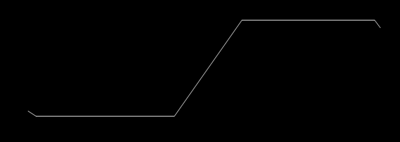

BIGAL Posted November 28, 2019 Posted November 28, 2019 (edited) Re doing was typo in code. (defun c:plhook ( / plent pt1 pt2 pt3 x pt5 add ang1 ang2) (while (setq plent (entsel "Pick pline Enter to exit")) (if plent (setq co-ord (mapcar 'cdr (vl-remove-if-not '(lambda (x) (= (car x) 10)) (entget (car plent)))))) (setq pt1 (nth 0 co-ord)) ; 1st point (setq pt2 (nth 1 co-ord)) ; second point (setq x (- (length co-ord) 1)) ; how many points- 1 as 1st point is 0 (setq pt3 (nth (- x 1) co-ord)) ; second last point (setq pt4 (nth x co-ord)) ; last point (setq ang1 (angle pt2 pt1)) ; angle ofthe pline (setq ang2 (angle pt3 pt4)) (setq add (getreal "Enter distance to add on")) (setq pt5 (polar pt1 (+ (* 0.25 pi) ang1) add)) ; 135 degrees (command "line" pt1 pt5 "") ; new line (setq ans (getstring "is line ok Y or N")) ; is it in correct direction (if (= "Y" (strcase ans)) ; y or Y (princ "ok") (command "mirror" "Last" "" pt1 pt2 "Y") ; flip line ) (setq pt5 (polar pt4 (+ (* 0.25 pi) ang2) add)) ; other end (command "line" pt4 pt5 "") (setq ans (getstring "is line ok Y or N")) (if (= "Y" (strcase ans)) (princ "ok") (command "mirror" "Last" "" pt4 pt3 "Y") ) ) ) (c:plhook) Â Edited November 28, 2019 by BIGAL 1 Quote
Abdulellah Posted November 29, 2019 Author Posted November 29, 2019 On 11/28/2019 at 6:23 AM, BIGAL said: Re doing was typo in code. (defun c:plhook ( / plent pt1 pt2 pt3 x pt5 add ang1 ang2) (while (setq plent (entsel "Pick pline Enter to exit")) (if plent (setq co-ord (mapcar 'cdr (vl-remove-if-not '(lambda (x) (= (car x) 10)) (entget (car plent)))))) (setq pt1 (nth 0 co-ord)) ; 1st point (setq pt2 (nth 1 co-ord)) ; second point (setq x (- (length co-ord) 1)) ; how many points- 1 as 1st point is 0 (setq pt3 (nth (- x 1) co-ord)) ; second last point (setq pt4 (nth x co-ord)) ; last point (setq ang1 (angle pt2 pt1)) ; angle ofthe pline (setq ang2 (angle pt3 pt4)) (setq add (getreal "Enter distance to add on")) (setq pt5 (polar pt1 (+ (* 0.25 pi) ang1) add)) ; 135 degrees (command "line" pt1 pt5 "") ; new line (setq ans (getstring "is line ok Y or N")) ; is it in correct direction (if (= "Y" (strcase ans)) ; y or Y (princ "ok") (command "mirror" "Last" "" pt1 pt2 "Y") ; flip line ) (setq pt5 (polar pt4 (+ (* 0.25 pi) ang2) add)) ; other end (command "line" pt4 pt5 "") (setq ans (getstring "is line ok Y or N")) (if (= "Y" (strcase ans)) (princ "ok") (command "mirror" "Last" "" pt4 pt3 "Y") ) ) ) (c:plhook)  greate job herro , very usefull lisp , one more thing for maximum benifit , can you do that with *. dcl window at right select hook side at start point , at left select hook side at end point .  after add hooks , can join both hooks to be with polyline as one object .  then select new connected polyline and fillet all poly segment together with predefined redius.  i am have confident to do that .    Quote
BIGAL Posted December 2, 2019 Posted December 2, 2019 (edited) Multi GETVALS.lspTry this  (defun c:plhook ( / plent pt1 pt2 pt3 x pt5 add ang1 ang2) (if (not AH:Butts)(load "Multi Radio buttons.lsp")) (if (= but nil)(setq but 1)) (if (not AH:getvalsm)(load "Multi Getvals.lsp")) (while (setq plent (entsel "Pick pline Enter to exit")) (if (/= plent nil) (progn (setq co-ord (mapcar 'cdr (vl-remove-if-not '(lambda (x) (= (car x) 10)) (entget (car plent))))) (setq pt1 (nth 0 co-ord)) ; 1st point (setq pt2 (nth 1 co-ord)) ; second point (setq x (- (length co-ord) 1)) ; how many points- 1 as 1st point is 0 (setq pt3 (nth (- x 1) co-ord)) ; second last point (setq pt4 (nth x co-ord)) ; last point (setq ang1 (angle pt2 pt1)) ; angle ofthe pline (setq ang2 (angle pt3 pt4)) (setq ans (AH:getvalsm (list "Enter length" "Hook length " 5 4 "30" "Radius" 5 4 "25" ))) (setq add (atof (nth 0 ans))) (setq rad (atof (nth 1 ans))) (setq pt5 (polar pt1 (+ (* 0.25 pi) ang1) add)) ; 135 degrees (command "line" pt1 pt5 "") ; new line (setq ans (ah:butts but "V" '("Flip " "Yes" "No"))) (if (= "No" ans) (princ "ok") (command "mirror" "Last" "" pt4 pt3 "Y") ) (command "pedit" (car plent) "join" (entlast) "" "") (setq pt5 (polar pt4 (+ (* 0.25 pi) ang2) add)) ; other end (command "line" pt4 pt5 "") (setq ans (ah:butts but "V" '("Flip " "Yes" "No"))) (if (= "No" ans) (princ "ok") (command "mirror" "Last" "" pt4 pt3 "Y") ) (command "pedit" (car plent) "join" (entlast) "" "") (command "fillet" "Polyline" "r" rad (car plent)) ) ) ) ) (c:plhook) Multi radio buttons.lsp  Edited December 2, 2019 by BIGAL 1 Quote

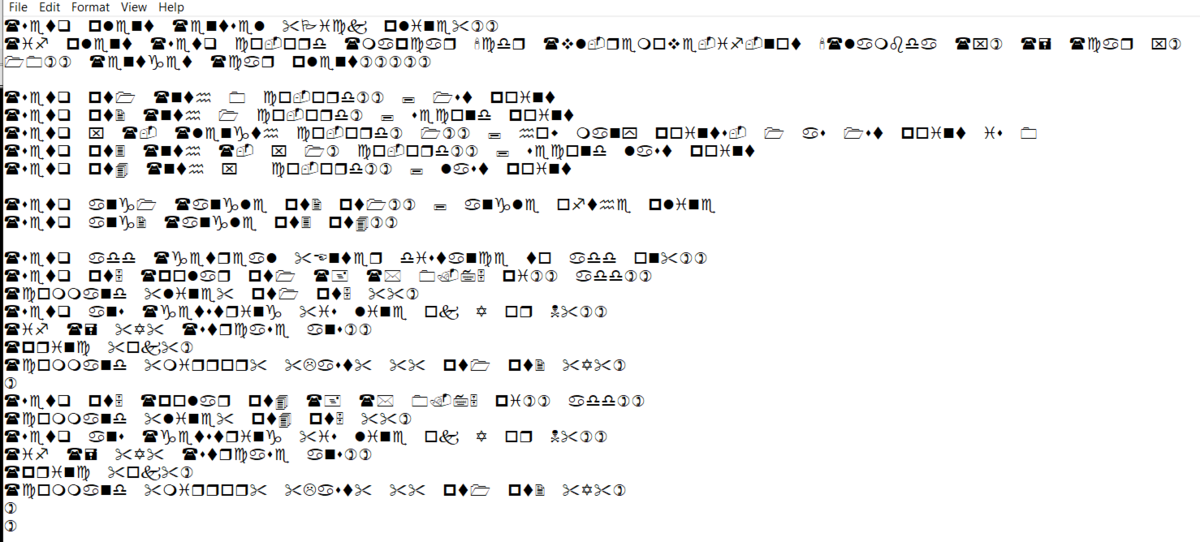

Abdulellah Posted December 3, 2019 Author Posted December 3, 2019 Very embarrassing, for your extra generosity, really you are a wonderful human  On 11/28/2019 at 6:23 AM, BIGAL said: Re doing was typo in code. (defun c:plhook ( / plent pt1 pt2 pt3 x pt5 add ang1 ang2) (while (setq plent (entsel "Pick pline Enter to exit")) (if plent (setq co-ord (mapcar 'cdr (vl-remove-if-not '(lambda (x) (= (car x) 10)) (entget (car plent)))))) (setq pt1 (nth 0 co-ord)) ; 1st point (setq pt2 (nth 1 co-ord)) ; second point (setq x (- (length co-ord) 1)) ; how many points- 1 as 1st point is 0 (setq pt3 (nth (- x 1) co-ord)) ; second last point (setq pt4 (nth x co-ord)) ; last point (setq ang1 (angle pt2 pt1)) ; angle ofthe pline (setq ang2 (angle pt3 pt4)) (setq add (getreal "Enter distance to add on")) (setq pt5 (polar pt1 (+ (* 0.25 pi) ang1) add)) ; 135 degrees (command "line" pt1 pt5 "") ; new line (setq ans (getstring "is line ok Y or N")) ; is it in correct direction (if (= "Y" (strcase ans)) ; y or Y (princ "ok") (command "mirror" "Last" "" pt1 pt2 "Y") ; flip line ) (setq pt5 (polar pt4 (+ (* 0.25 pi) ang2) add)) ; other end (command "line" pt4 pt5 "") (setq ans (getstring "is line ok Y or N")) (if (= "Y" (strcase ans)) (princ "ok") (command "mirror" "Last" "" pt4 pt3 "Y") ) ) ) (c:plhook)   Quote
Abdulellah Posted December 4, 2019 Author Posted December 4, 2019 Sorry, if you can explain how to run attachments in the last reply, you only can help me . Quote
BIGAL Posted December 4, 2019 Posted December 4, 2019 You need to save the two files in a Autocad supported path or edit the "Load path. Â (if (not AH:Butts)(load "c:\\myprograms\\lisps\\Multi Radio buttons.lsp")) (if (not AH:Butts)(load "c:\\put your path here\\Multi Radio buttons.lsp")) Â Â 1 Quote

asos2000 Posted December 14, 2019 Posted December 14, 2019 Could you upload a file with the pline before and after Quote

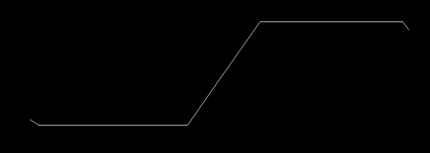

BIGAL Posted December 15, 2019 Posted December 15, 2019 This is latest has offset radius and angle pick pline anywhere. Â (defun c:plhook ( / plent pt1 pt2 pt3 pt4 ang3 pt5 add ang1 ang2 ang3) (if (not AH:Butts)(load "Multi Radio buttons.lsp")) (if (= but nil)(setq but 1)) (if (not AH:getvalsm)(load "Multi Getvals.lsp")) (while (setq plent (entsel "Pick pline Enter to exit")) (setq co-ord (mapcar 'cdr (vl-remove-if-not '(lambda (x) (= (car x) 10)) (entget (car plent))))) (setq pt1 (nth 0 co-ord)) ; 1st point (setq pt2 (nth 1 co-ord)) ; second point (setq x (- (length co-ord) 1)) ; how many points- 1 as 1st point is 0 (setq pt3 (nth (- x 1) co-ord)) ; second last point (setq pt4 (nth x co-ord)) ; last point (setq ang1 (angle pt2 pt1)) ; angle ofthe pline (setq ang2 (angle pt3 pt4)) (setq ans (AH:getvalsm (list "Enter length" "Hook length " 5 4 "30" "Radius" 5 4 "25" "angle " 5 4 "45"))) (setq add (atof (nth 0 ans))) (setq rad (atof (nth 1 ans))) (setq ang3 (* pi (/ (atof (nth 2 ans)) 180.0))) (setq pt5 (polar pt1 (+ ang3 ang1) add)) ; 135 degrees (command "line" pt1 pt5 "") ; new line (setq ans (ah:butts but "V" '("Flip " "Yes" "No"))) (if (= "No" ans) (princ "ok") (command "mirror" "Last" "" pt1 pt2 "Y") ) (command "pedit" (car plent) "join" (entlast) "" "") (setq pt5 (polar pt4 (+ ang3 ang2) add)) ; other end (command "line" pt4 pt5 "") (setq ans (ah:butts but "V" '("Flip " "Yes" "No"))) (if (= "No" ans) (princ "ok") (command "mirror" "Last" "" pt4 pt3 "Y") ) (command "pedit" (car plent) "join" (entlast) "" "") (command "fillet" "Polyline" "r" rad (car plent)) ) (princ) ) (c:plhook) Â 1 Quote
