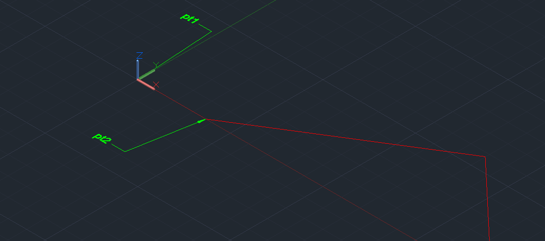

Ok...here is what I do manually.  I take a solid like this: image.png.9a51834650e3fa9baec0529d7713f31a.png
This is a solid bar, not a tube.  I have no input on how its created, my customer does this.   He uses Catia.  I go through several  steps to get it to something Autocad can read.  In the end, I'm left with a solid.  The shapes vary wildly.  I then use the shade command to make it a wireframe, thusly:
I then draw lines center to center on the straight parts of the tube like this (red lines)
at this point, the solid no longer matters and can be erased, but that is optional.  The bit that matters is that I zero- fillet these straight lines, thusly:
At this point, I need to identify the cooridinates of each of the intersections and put that in a table.  For instance, the first end point (pt 1) is obviously 0,0,0.  The next point (pt2) is  X = 1.8430     Y = 0.0000     Z = 0.0000.
and so forth all the way to the end of the tube.
This gives me a bend data table similar to this ( and this is not for this part, just an example):
This data allows me to feed my cnc bender the info it needs to bend the tube.

 another way to skin the cat, crude and rude.
Explode the 3d-solid to surfaces,
As a bended tube shall be, as far as i Know, start and end in a straight tube, and it shall be only one curve between straight tubes.
So, try to change to  same  colour each straight , and then  to other color  ech curves
Select straight  by colour , copy ss, and  change to a new layer the copied to a new layer.
Then and in a loop, explode one by one , and get both circles,  get the center , as follow

I try to use TRANS to equal bot centers , but it is far away my knowledge
As it can be seen , assoc 10 give not the real XYZ .  As by VLA-GET-CENTER
See attached

Hi Jack, I had a time to play with this task in the way you are looking for, and I did it... Test this code :

But something's wrong... When I output CSV file from your posted 3DTUBE and get data and then I use that data with Roy's code, I get different 3DTUBE... Is it perhaps the thing that Roy used coordinates of line intersections and not like you showed in your last table XC, YC, ZC - C is circle I suppose... Jack, what exactly do you need : XC, YC, ZC or compatibility between Roy's code and my?
See attachments...
M.R.
test-tubes.dwg TUBE.csv
I've changed my lisp, should be more reliable now... But still, I can't be 100% sure, if you find some lack, upload DWG for me to see it...
Regards, M.R.

marko_ribar, your lisp works perfectly, at least on the two parts I've tried it on this morning.
