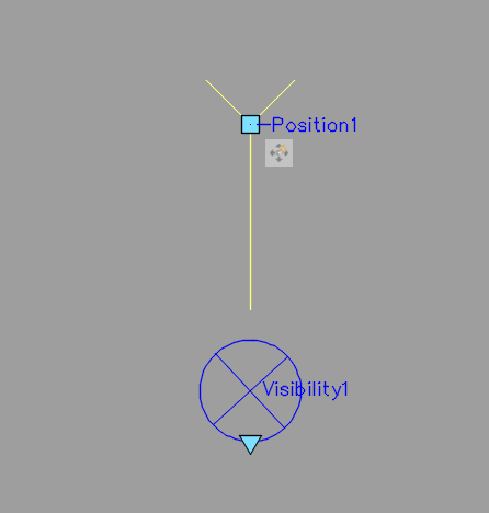

So I have a block which contains a 2 objects, a circle with a crosshair and then a split line. I want to be able to move the line and when I do so, the line is still pointing at the center of the circle. How would I accomplish this? Is it something with a rotation command or a constraint? Thanks for any help all.
Create a block with those objects. Go into the block editor. Pull up the dynamic block toolbox. Create a Rotation parameter centered on the circle. Create a Rotate action that includes the split line. Save and you're done.

I've done that but all that seems to do is create a point to rotate the line about, what am I doing wrong. Here is the file for your reference. line length example.dwg
I appologise I replied to @BIGALwithout really reading your question properly. The dynamic action you require is a polar stretch this will allow you to move the split line anywhere you want including away from the crosshairs but keep it pointing at that crosshairs.
Okay, I misunderstood the question. You want to move the split line to an arbitrary location, not a fixed distance from the center of the circle. My block-fu is not up to the challenge. Sorry.
