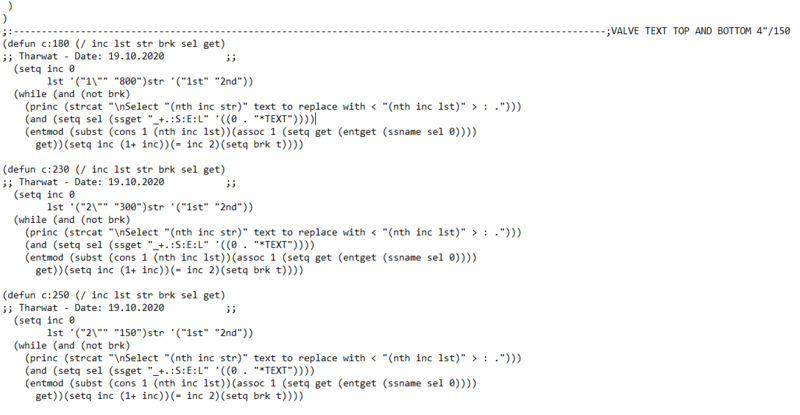

ant7 Posted October 21, 2020 Author Share Posted October 21, 2020 (edited) this is what I did, I hope I did it right, when I load it into AutoCAD it works, I show only 3, but there are like 20 or more, but I i cant thank you enough, Edited October 21, 2020 by ant7 Quote Link to comment Share on other sites More sharing options...
