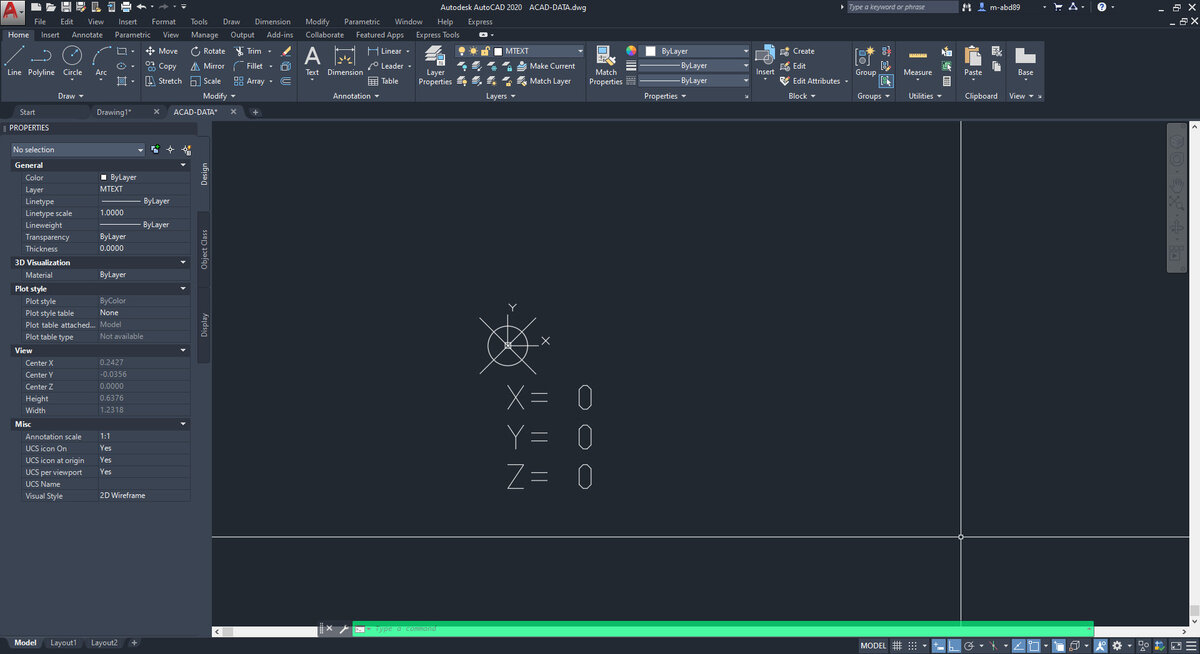

I face the same problem every time I export the data from Excel to AutoCAD which is a point exported on location X:0.00 , Y:0.00 , Z:0.00 I don't know why it exports a point in that location ?!
Can someone please help me?
Look to the attached picture to be more clear
Thanks

What is your code?

That would be the Default Origin in modelspace, I should think.    :|
Never do that, so no experience with it specifically.

Kalsefar
@SLW210
Sir,
I attached Excel file have the code
This is the code :

My VBA is limited but looks like Range("START_1") is starting at row 2 and not row3.

No, I tried still have the same problem

See my answer on Autodesk forum, in any case did you try to trace a line from coords 0,0 settled by hand not by pointer ? just to understand if really your procedure point @0,0 coord.

Probably  I made some confusion, in any case did you try to trace a line from coords 0,0 settled by hand not by pointer ? just to understand if really your procedure point @0,0 coord.
