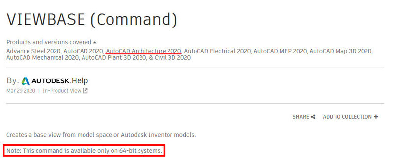

Cad64 Posted October 24, 2020 Share Posted October 24, 2020 33 minutes ago, f700es said: Um, 'Viewbase' command runs in Acad Arch 2021 for me. Yep, you're right. I guess I should have double checked. The Autodesk Knowledge Network say that it is available in Autocad Architecture. But it also says it's only available on 64 bit systems. Maybe the OP is running it on a 32 bit system? Quote Link to comment Share on other sites More sharing options...
