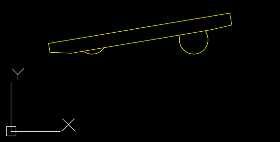

align block to curve with 2 "base points" / car along curve
B.N.
Xline can intersect the curve in various places - how to choose the correct intersection  ?
best regards
Woldo
caralign_v11.dwg
This is close I need to tune it a bit to make it work correctly. Your block needs to be correct size ie say 2400 between wheels where they touch the pline. If its a different measurement need to know that in code. I rescaled your block using bedit. Its called Holden now an Aussie car. They are palced with a spacing in this case I chose 0.5m
new block.dwg
Edited by BIGAL
caralign_v11_lrm.dwgHere's an approach that will work if the curve is a spline.

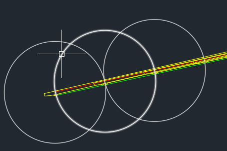

The program assumes that the two points of a block that will be required to lie on the spline are the block's base point and a point a known distance (L) on the x axis of the block. The program sets the base point on the spline and then determines then determines the location of the second point on the spline via numerical methods, i.e., it make a series of guesses.  The first guess is a distance L along the spline.
To use a spline in the sample file caralign_v11.dwg I modified the block named "auto" such that the radius of the two arcs are the same (0.35).  The modified block is named "auto-2".
Auto-2
The distance between the centers of the arcs was not modified. It is 2.4846.  I then created a spline that closely represented the polyline path.
The green curve in the image below is that spline.  An offset spline (red) is created 0.35 from the "path" spline.  The program ArraySpline is then used with a distance of 2.4846. The user may specify the distance between each block instance.  In the example below I used 3. The offset curve is used as the path to guarantee that the arcs will be tangent to the original spline.
The program could be easily modified to place a block at a specified location on a spline.

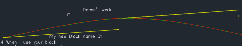

First of all, I would like to thank Mr. BIGAL and Mr. Irm for their support.
Thanks to Mr. Irm's I understood the idea of precisely inserting blocks on a curve
Regarding Mr. Irm's code, I have a few questions about whether it would be possible to make the same code with pollinia and so that auto-2 could be spaced every 5th unit, I have written down the requests in detail below
1) my goal is to set a single auto-2 block every 5 units  This code  insert  blocks  step  by  step (one by one)
2) the second important reason is that I try to avoid saltini because it is not visually accurate, can you do the same with pollnia?
3 Despite all my attempts, I cannot modify the code to insert it every 5 blocks
4 When I use your block which has modified geometry 200 then autolisp works. But if I create only block 01, auto lisp does not work correctly, it arranges the blocks horizontally without loops only with each click of the mouse cursor.

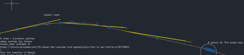

5 when I transform pollnies using autolisp (by Advisor marko_ribar available at https://forums.autodesk.com/t5/visual-lisp-autolisp-and-general/poly-line-to-sp-line/td-p/6379603 ) then the insertion of blocks ends in the place where the spline curve has a lot of points (photo 6)
AS_Widoczność_200_01.dwg
Edited by panczykwaldemar
I'm atached draw

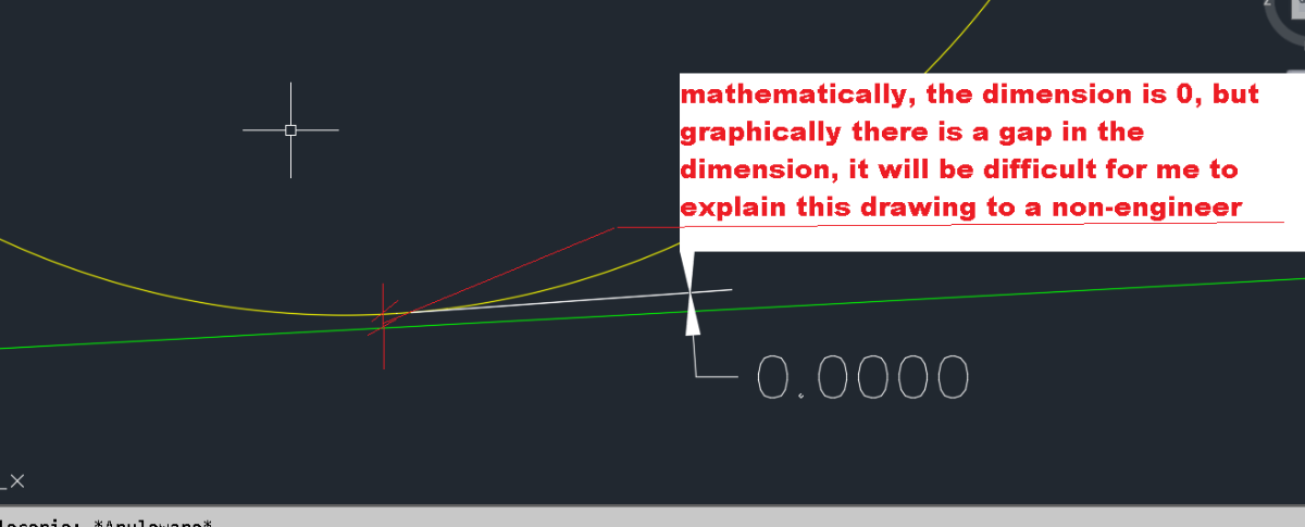

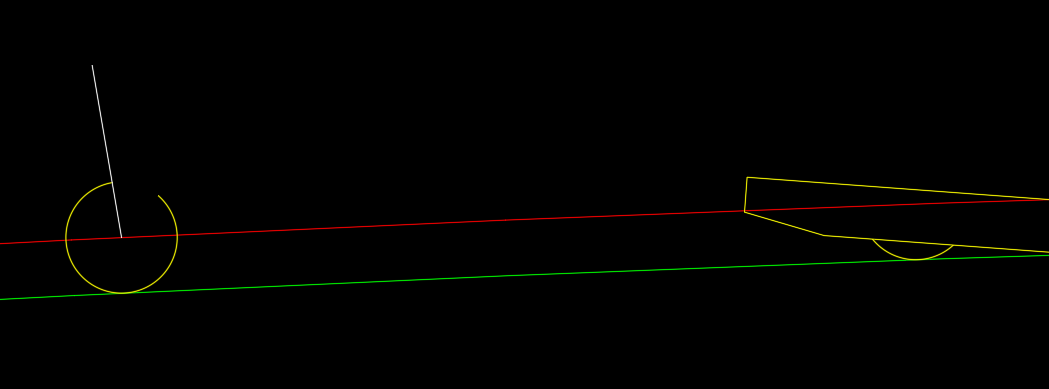

@panczykwaldemar  There are several factors that affect the computational and display precision. Computationally, the statement:
(while (< i 20) ; sets maximum interations for solution
as noted sets the upper limit for how many guesses will be made before the program quits.
The statement:
(if (< err 0.0001)
Determines how closely the required length to the second point must be met.
Both of these value could be adjusted to yield more accurate results.  I experimented with a few values, e.g., set iterations to 100 and err to 0.00001.  These changes had little affect on the displayed results.

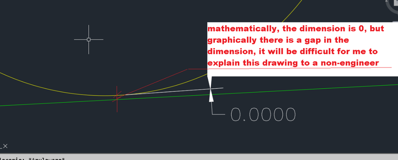

After further analysis I've concluded that it is an error in how splines are displayed in AutoCAD.   In the following image a point was added using osnap nearest to the spline.  Note that is not exactly on the line.  Also note that the center of the selected arc is slightly off the spline.
I have found that the display error for splines is more pronounced as they get longer.  For example, the images below shows your spline trimmed and a detail of the arc/spline contact.
Note that the arcs touch the spline.
I suggest using arrayspline on trimmed portions of the spline.
