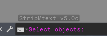

Just to show that I am using Stripmtext
After I ran that routine, I tried changing the objects to a different style then changing them back
but I still have the discrepancy between the Properties Dialog and the Text Formatting bar.
Edited by ILoveMadoka
