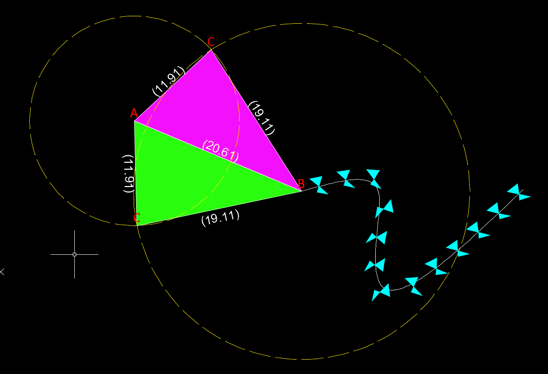

Tsuky Posted May 29, 2023 Share Posted May 29, 2023 Quote One little detail you guys seem to miss - if a triangle has known length of all 3 sides, circles drawn from any two corners will always intersect at 3rd corner. Someone has to explain to me the difference between these two triangles of the same dimensions...! 1 1 Quote Link to comment Share on other sites More sharing options...
kirby2 Posted May 29, 2023 Share Posted May 29, 2023 @Tsuky The two triangles P1-P2-P3 and P1-P2-P3' are both possible given two points and the radial distances to a third point. However, only one is (likely) the correct corner of the triangle for the purposed of laying out point P3 . Both triangle have identical area and share the baseline segment P1-P2 @vanowm Just curious what situation are you dealing with where you always know the third point is on a certain side of line segment P1-P2? e.g. segment P1-P2-P3 is always counter-clockwise such that P3 is always on the right hand side of baseline P1-P2, etc. I work in civil engineering / surveying and either situation can often be the case. Quote Link to comment Share on other sites More sharing options...

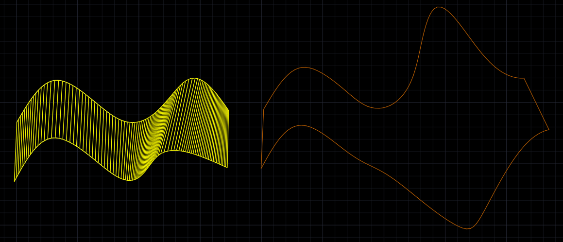

vanowm Posted May 29, 2023 Author Share Posted May 29, 2023 @kirby2 Rectangle divided into 2 triangles. I'm working on a method to flatten 3d mesh (rulled surface) into 2d contour: Quote Link to comment Share on other sites More sharing options...
