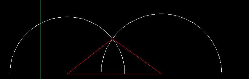

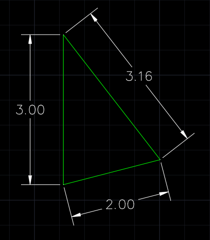

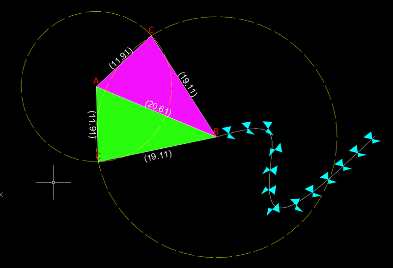

Get coordinates of 3rd point based on known distance between it and 1st and 2nd point?
vanowm
Try this:
(defun c:pp(/); l1 l2 l3 p1 p2 p3 p4 p area h h1 ang)
  (setq l1 3.0 l2 2.0 l3 4)
  (setq p1 (list 0 0) p2 (list 0 l1))
  (setq p (* (+ l1 l2 l3) 0.5))
  (setq area (sqrt (* p (- p l1) (- p l2) (- p l3))))
  (setq h (/ area l1 0.5))
  (setq h1 (sqrt (- (* l2 l2) (* h h))))
  (setq ang (atan h h1))
  (setq ang (if (> (* l3 l3) (+ (* l1 l1) (* h h))) (- PI ang) ang))
  (setq p3 (polar p1 (+ ang (angle p1 p2)) l2))
  (setq p4 (polar p1 (- (angle p1 p2) ang) l2))
  (command "line" p1 p2 p3 p1 p4 p2 "")

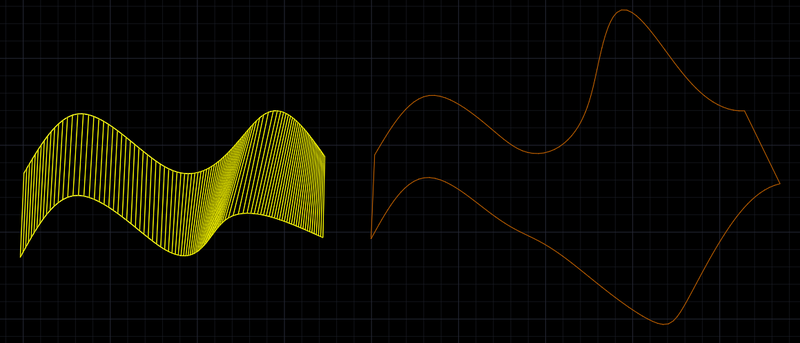

@fuccaro
Thank you very much it's working perfectly now.
My old code would process 2000 triangles and draw outline in 35 seconds in wireframe view and 1m10s in shaded, with this algorithm it takes 3 seconds regardless of the view type. Huge improvement!
Edited by vanowm

Here's another possible method -
(defun tri-ppll ( p1 p2 l1 l2 / a b p x )
    (if (< 0 (setq a (distance p1 p2)))
        (setq b (* l1 l1)
              x (/ (+ (- (* a a) (* l2 l2)) b) (+ a a))
              p (mapcar '+ p1 (trans (list (sqrt (- b (* x x))) 0.0 x) (mapcar '- p2 p1) 0))
To test:
(defun c:test ( / a b p q x )
    (if (and (setq p (getpoint "\nSpecify 1st point: "))
             (setq q (getpoint "\nSpecify 2nd point: "))
             (setq a (getdist p "\nSpecify 1st side length: "))
             (setq b (getdist q "\nSpecify 2nd side length: "))
        (if (setq x (tri-ppll p q a b))
            (mapcar 'l (list p q x) (list q x p))
            (princ "\nThe two points must be distinct!")
(defun l ( a b ) (entmake (list '(0 . "LINE") (cons 10 a) (cons 11 b))))
Edited by Lee Mac
