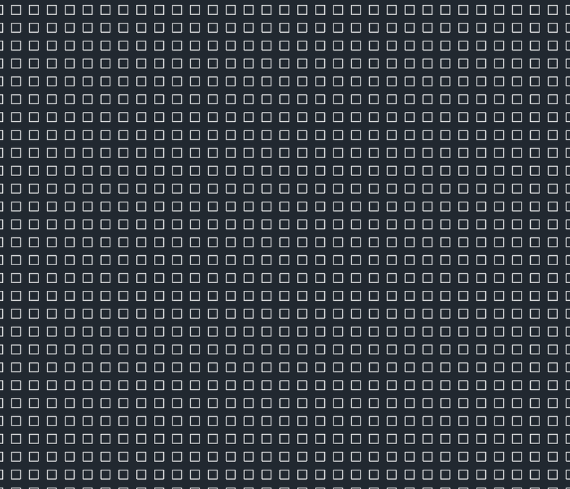

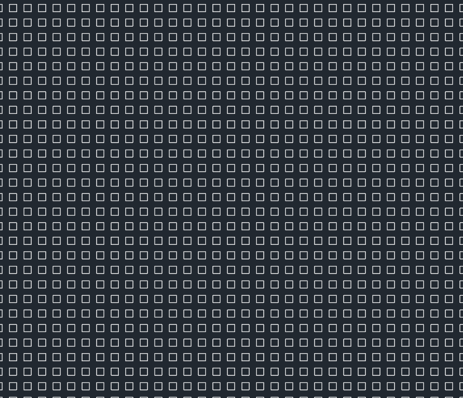

Hi! I’m not sure if this is the correct place to post this but I’m a graduate student working on a project where I have a 11.97 x 11.97 mm box that im trying to fill up with smaller boxes with sizes .002 x .002 mm, .002 mm away from each other in the x and y direction. Ive hit a point now where autocad has slowed down significantly is there any way to get around this? Any help would be appreciated!

Yes I used it initially to get the first row and from there I would just copy and paste it above it and then I would copy those two rows and do the same thing until I filled the whole box. The issue now is that I still have so many objects in that box that its causing autocad to lag

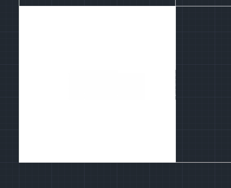

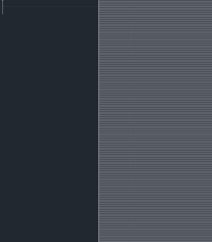

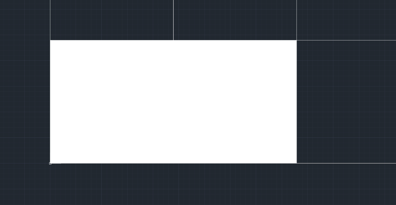

OK, you are overloading AutoCAD.
Trying a hatch, I get a message that the pattern is too dense. If I try a hatch at 10 times the box and spacing dimensions, I get a picture which could be hatched with a solid fill, but zooming in, one can see the individual boxes.
I got a pattern to fill the required 11.97 square using the following definition (which is 10 times the required spacing):
*SB, small boxes
0,0,0,0,0.02,0.02,-0.02
90,0,0,0,0.02,0.02,-0.02
When I tried to reduce the scaling to 0.1, I was not able to as my entered figures of "0.1" were ignored and "1" was substituted. Clearly AutoCAD was having none of it!
Pondering on the purpose of filling a square with 2993x2993 smaller boxes (=8958049), I can see no valid reason for it, but someone possibly knows otherwise. Perhaps the point IS to test the limitations.
Someone else can have a go at using the correct spacing by replacing the "0.02" with "0.002" in the above definition. My version of AutoCAD does not like it!

Im not sure how to use hatch, I tried using it by typing in hatch and clicking in between the squares but all it does is it begins to highlight each individual square until it highlights the whole row then it makes the rest of it white.
My project as it is already looks like what you posted above when i zoom in and out (this is before doing hatch)

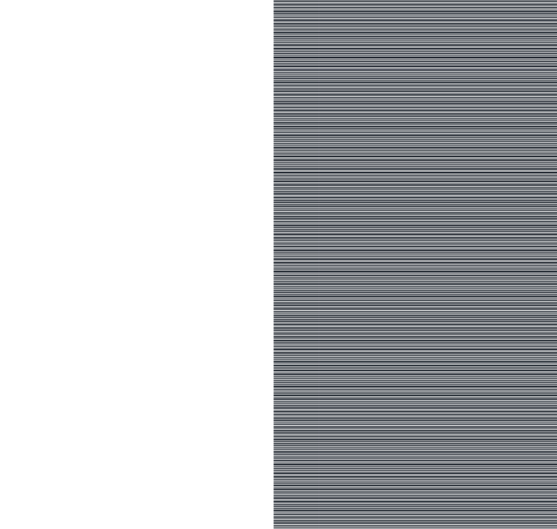

Saved HB.pat, hatch custom scale 1, ok my Bricscad said exceeded number allowed, but reset to some 100000000 etc then hatch appeared.
